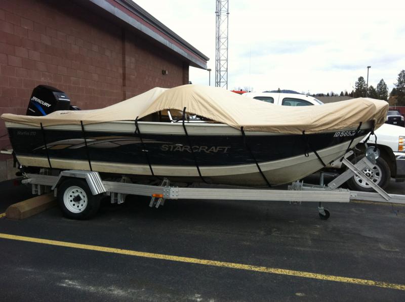

I have a customer that wants me to redo the green vinyl band on their boat. I've attached a picture. How would I go about re-creating something like this? How would I calculate for curve and all that accurately?

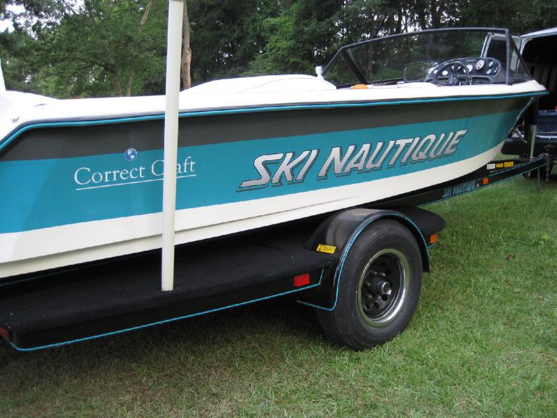

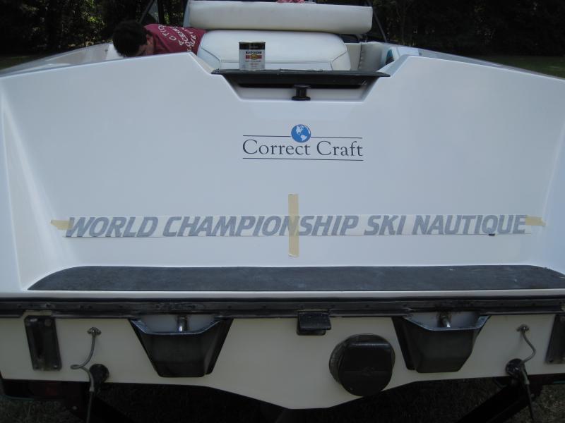

visual800
I just taped a straight line on the boat and laid the vinyl on top it was still basically a straight line. Your boat appears to have same qualities and I would assume it would be no problem. Its hard to tell on boats but man they sure do have 1 hell of an angle on them

megacab
if the old stripe is vinyl, i would remove it and use knifeless tape or wrap cut for the new one to get it exactly the same size as the old one. the old vinyl coming off should leave a nice ghost line that should be easy to follow. i know this doesn't answer the "how to" question of figuring out the curves on it. but it offers a simple solution to your problem. IMHO, of course.
