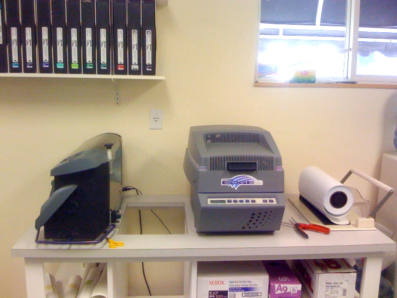

I'm not a big composer fan. I design in other programs and just export to it. Use composer to set colors and cut lines and then let her go.
On long runs I'll load into the plotter once the last color starts. We built these tables, theres a catch basket on the floor past the plotter.. I like the edge. They just work.
