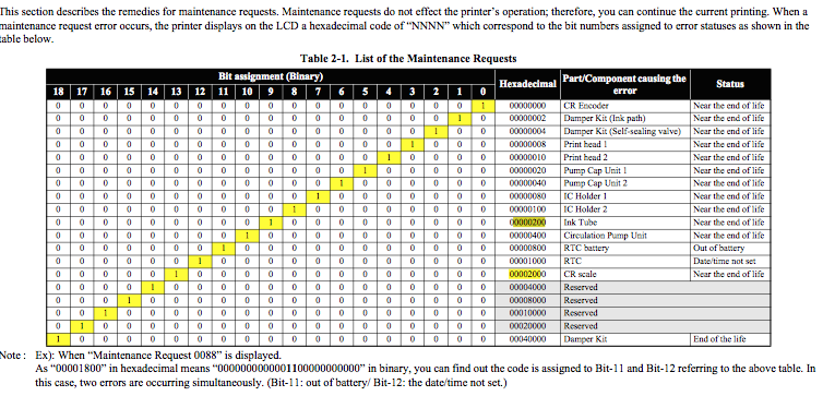

I just had a maintenance part replacement message come up on my S70. The number is 0000200. Just curious if anyone knows what that may be?
ProColorGraphics
Mine is too, I was just curious if anyone knew of hand. They said to shut it off and it should go away, which it did. Otherwise I tech would have to come out. It was actually #00002000
