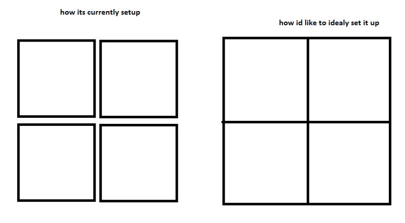

Right now I'm doing 500 4x4 squares. so i create the 1 design, then Step and Repeat it leaving a .1 space between each design.
I have it setup as 4x4" and then a .1 space and 4x4"
so there are 2 cuts between each square, is there an easy way to set it up so that there is just 1 cut between the 2 squares (less waste and easier to pull apart mainly being much easier to pull apart)
I hope I'm making sense...
here is a rough and dirty pic showing what i mean.

Set it up so that only the top line and left line are there, then step and repeat with zero space in between. You will either have to manually cut the one very final far right and bottom line in each group, or manually insert it in the file after you step/repeat, but I think this is what you're after.
hmm thats one way to do it!
As described in an earlier post. You need lines instead of "squares".
Ill have to try this..Im surprised there is a work around and not an actual setting for this tho :)
Thanks

Doing that will make the plotter cut over the same place TWICE everywhere except the outer borders. Follow the advice of only left and top lines.
