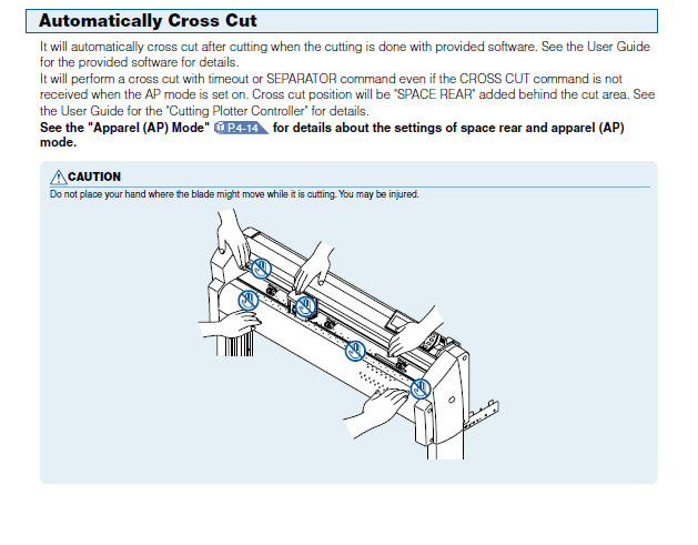

Snydo
Or you may have apparel mode on?
idsignsil
Snydo is the winner. It was set to apparel mode. Turned it off and now everything is peachy. :thankyou: Figured it was something stupid that I missed setting it up.
