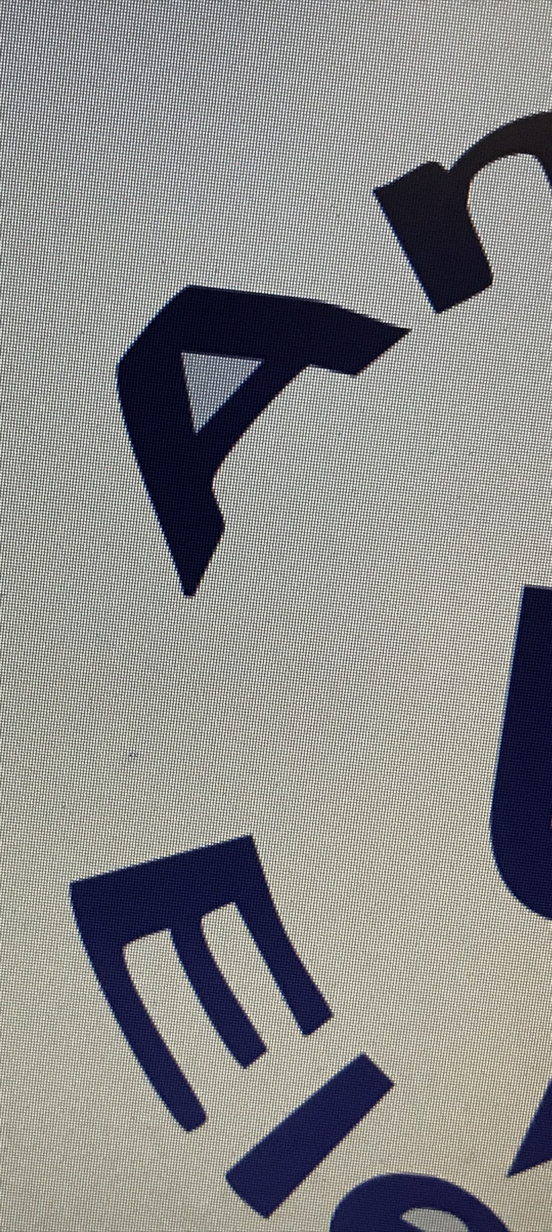

I have this logo to create and I am trying to curve the top word around the top of a circle shape and the second word around the bottom of a circle shape. Any ideas how to in Corel. It wants to distort the sides. I just want to move the corners and the centre’s if possible. I am using enevelope to transform it? Thanks
kroger
The difficult part For me is to get the top and bottom of each word to take on the curve of the circle.

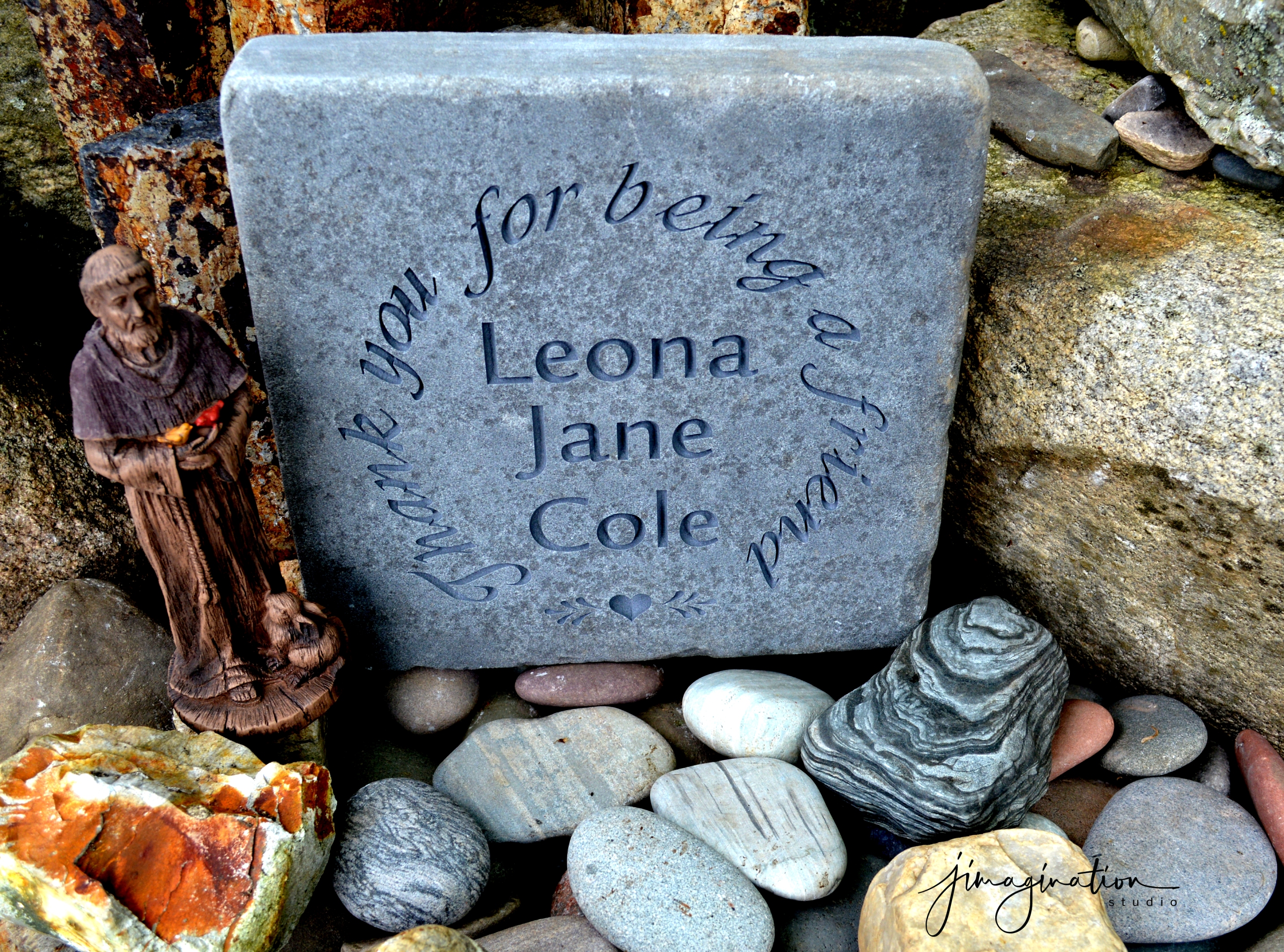

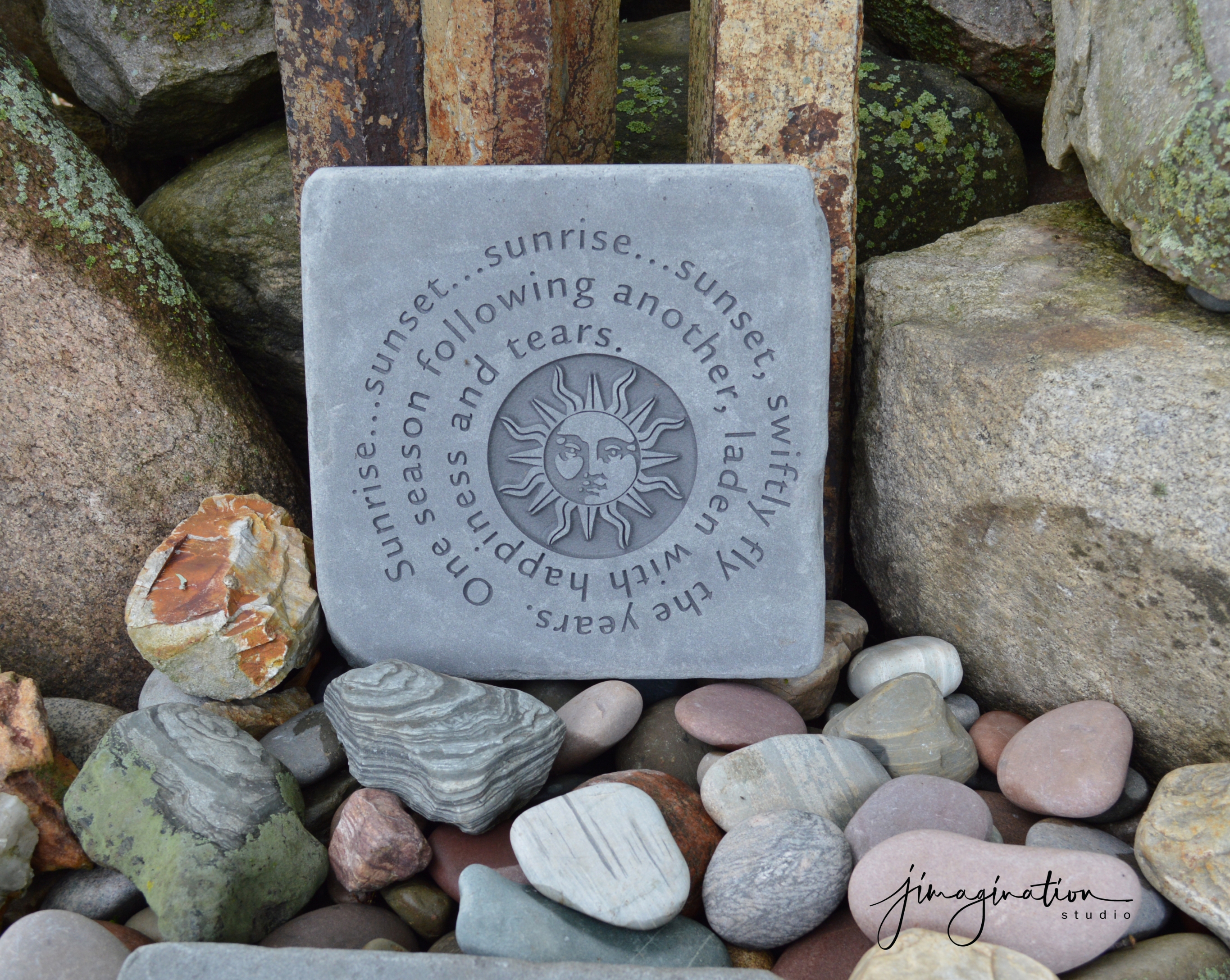

I run Illy, Corel, SignLab, and Gerber Omega. NOBODY beats Omega. It's absolutely fantastic for doing text on a circle, and on a spiral. It does not distort the letters, and it retains 100% edit-ability for font, kerning or any other characteristic (inline, outline, etc...).
For circles, there is a function in the text editor called "arc line", and all you need to do is specify a few parameters and boom...it's done. You don't have to mess with typing on a path. The spiral takes a bit more editing, but it's extremely easy.
