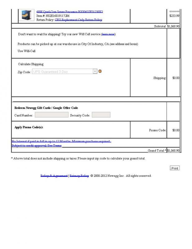

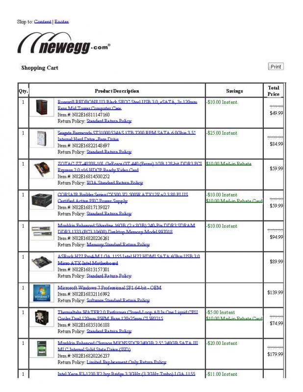

Here is what you could have got for $1068.90:
Intel Xeon E3-1230 V2 - Water Cooled with Thermaltakes new closed loop system
Mushkin 16GB DDR3-1333
Mushkin SSD 240GB Sata III - I use these and they are awesome.
Seagate 1TB
GeForce GT440 Graphics card - Dual DVI and more than enough processing power for your printing/designing needs
A case big enough to add 6 HDDs in the future, A rock solid power supply, and a business class desktop motherboard.
For $350 right now you can get a 27" 2560x1440 LG Panel IPS monitors, they work great and are built in Korea by the same factory as the samsung LCDs.

One problem with that previous configuration is the mixture of an Intel Xeon class processor with a desktop series chipset and standard desktop non-ECC RAM. That will not work. While yes the Xeon and the motherboard are both LGA 1155, the motherboard is definitely not a business class desktop motherboard, and is not a server-grade chipset that will run a Xeon chip, they use different memory controller configurations and have access to different PCI-Express slots and additional compatibility differences.
Yes, on a server-series LGA1155 chipset, like the C202, C204, or C206 you can put in desktop series Core i3 processor, but the reverse is not true for the desktop chipset motherboards. Additionally, on a C202, C204, or C206 chipset motherboard you can run non-ECC memory if you're running a Core i3 processor, but stepping to any Xeon processor requires either ECC Unbuffered or ECC Registered memory depending upon the chipset series and processor series. This is true for any server-class processor.
