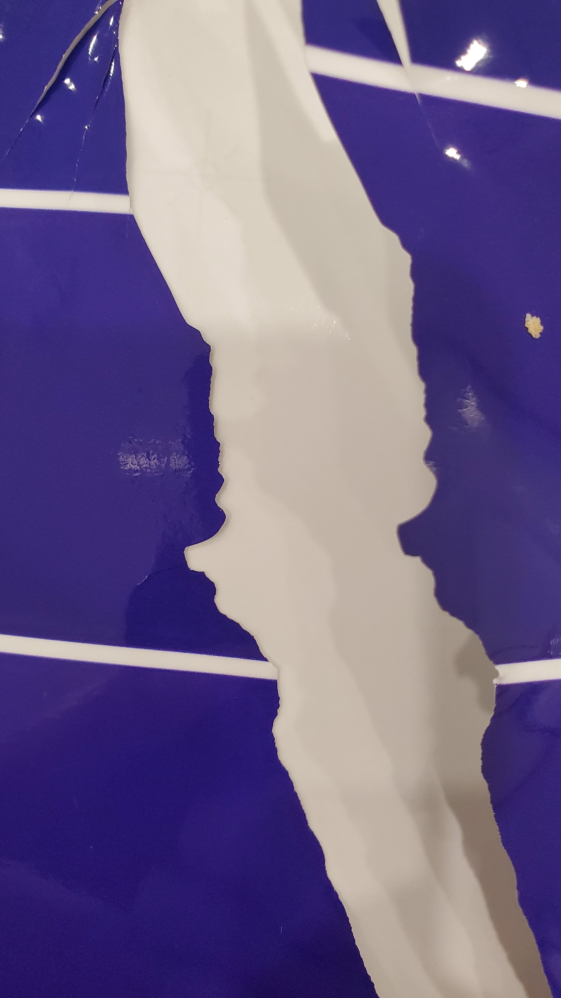

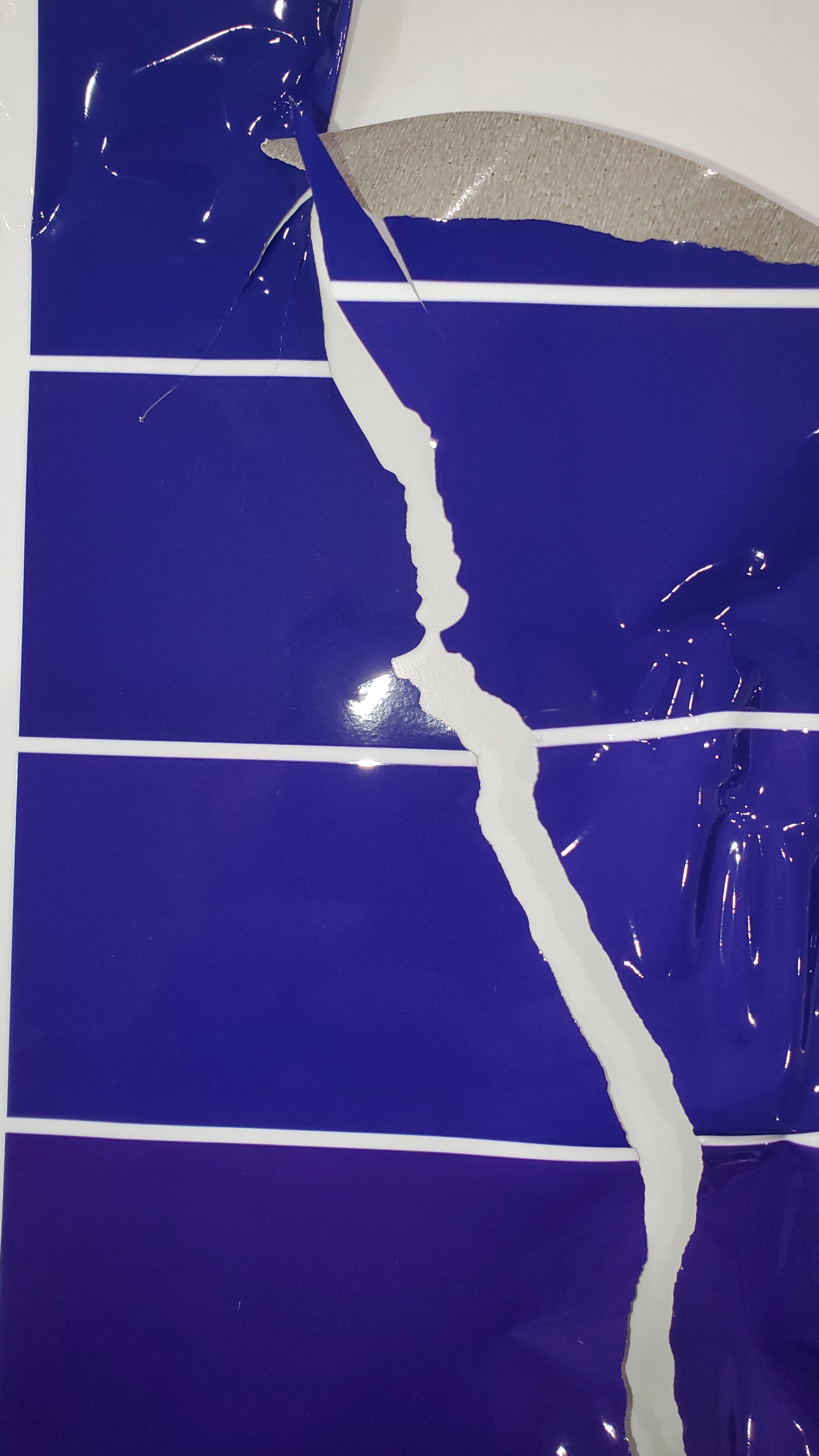

I have a Mimaki UCJV300-160 with LUS-200 inks. This machine was purchased prior to my arrival and was chosen for the ability to go direct from print to lamination to install while having a large color gamut. The problem we have encountered is the material becomes extremely brittle and tears like paper at times. UV lamps have been checked and are within service specs. A variety of 3M materials have been tried with limited changes to success. We have tried IJ180, IJ280, IJ480 and various laminate combinations. We have tried Avery 1105 with Avery 1360Z laminate and have significant silvering issues, even with using a GFP 363TH with top heat and firm pressure. Has anyone had success with this machine and ink set or has anyone had similar issues? Our primary focus is on buses, are large flat side panels with complex curves on front and rear. The closest I may have come to a solution is using Avery 1105 and laminating with 3M 8428. Anyone have ideas or similar experience?

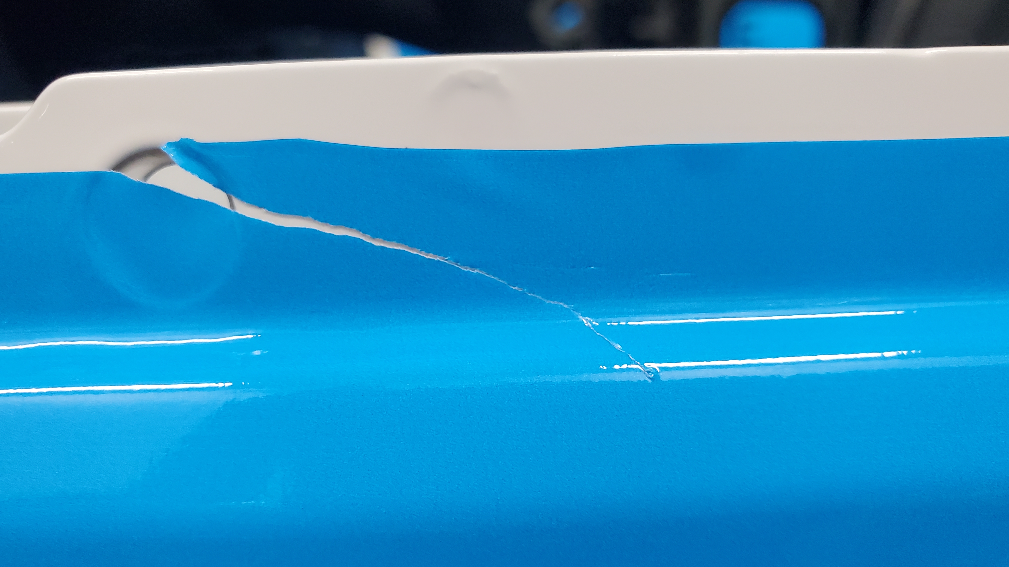

This is what my failure tends to look like.
Yikes, not what you want to see when installing graphics. I would honestly suggest checking out Onyx or if you're otherwise happy with Rasterlink, see if you're able to create/use custom profiles within that workflow.
I would really think that reducing ink limits would help with the vinyl becoming so brittle.

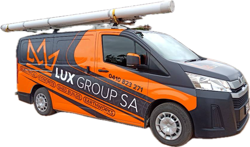

Without getting into a Ford vs Chevy thing, we print 30-50 metres of 3MIJ180 and IJ280 on our Colorados every day.
90% of it goes on vehicles (like the one attached), and 10 metre truck sides.
UV ink changes the surface tension of the vinyl which is what causes tearing to start, also the Matte finish of the ink retards the laminate from bonding well to the print (Silvering).
Colorado UV prints works a lot better for wraps than other UV prints mainly because it prints a High Gloss finish which the laminate bonds to really well, helping keep it all together.
That said, the biggest difference you can make to your tearing issue is to use URETHANE LAMINATE.
It's way, way tougher than Cast for tearing, doesn't scratch, and is way more durable generally, 3M, Oracal, Avery, they all make it.
It's pricey, but so much better than Cast laminate, strangely it never gets a mention on this site.
We use Oracal 279.
