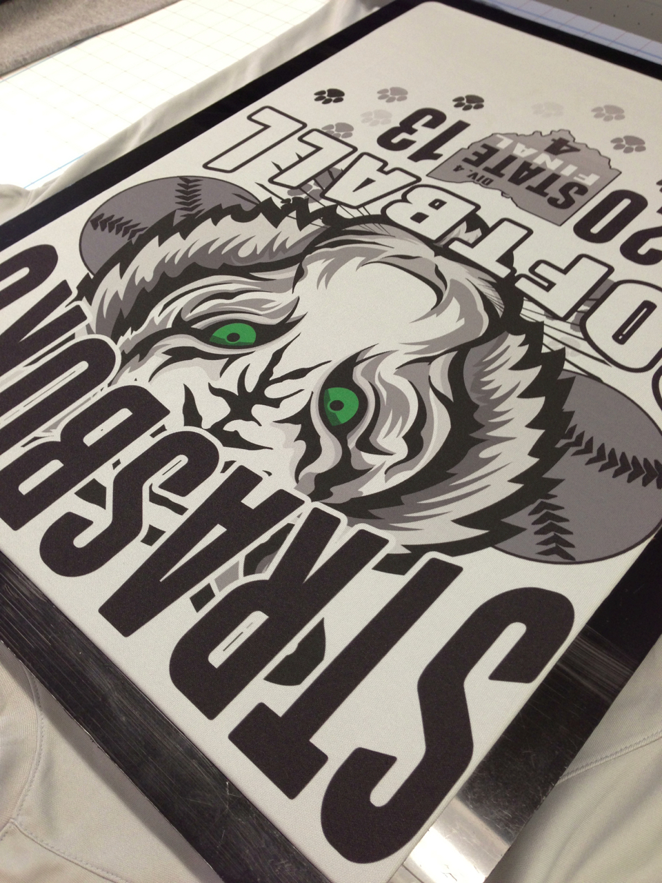

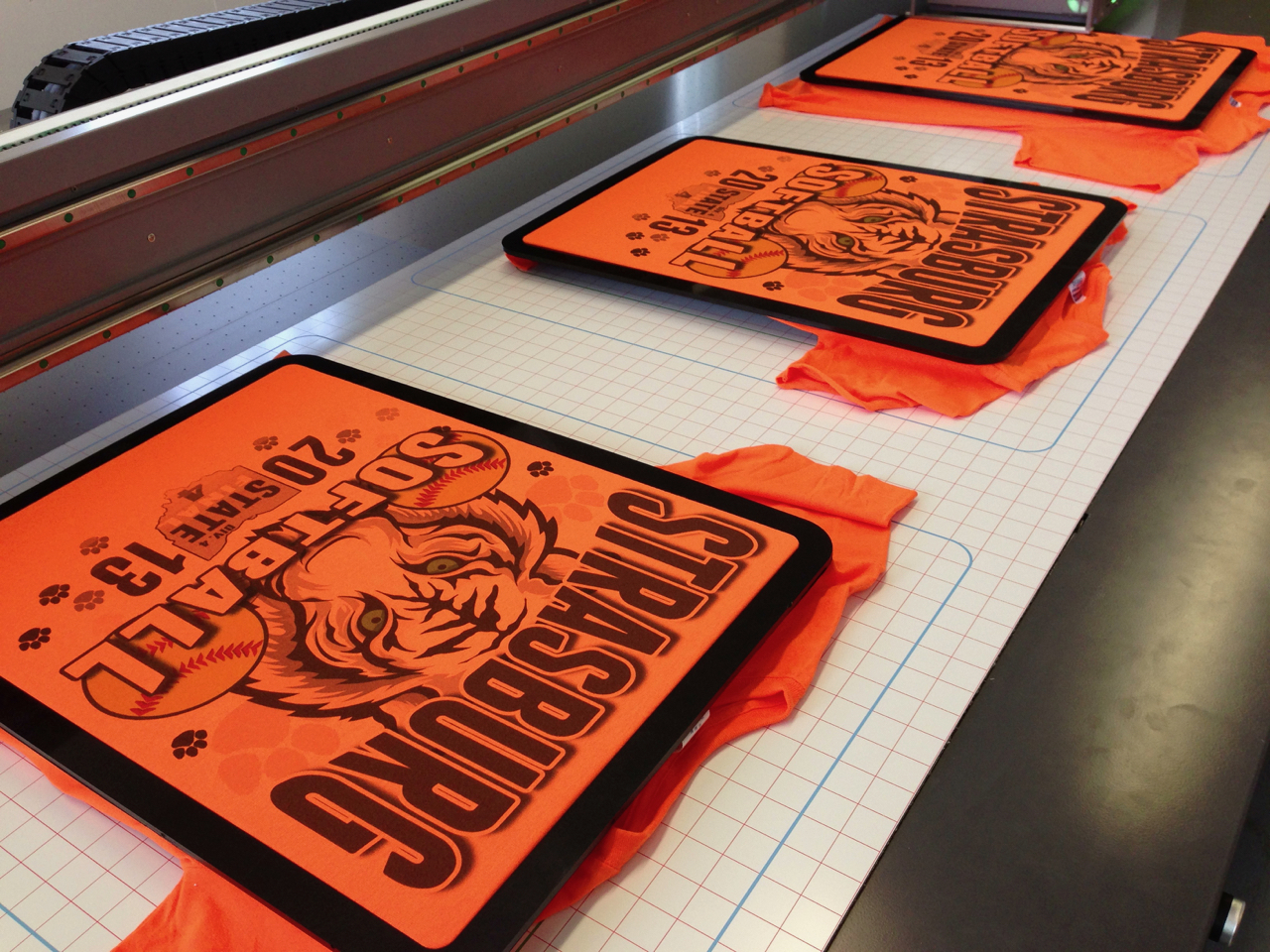

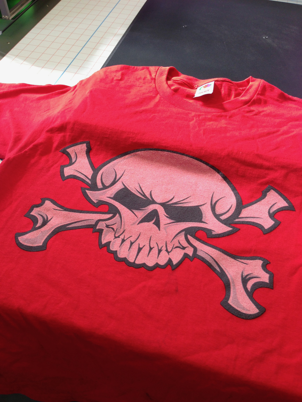

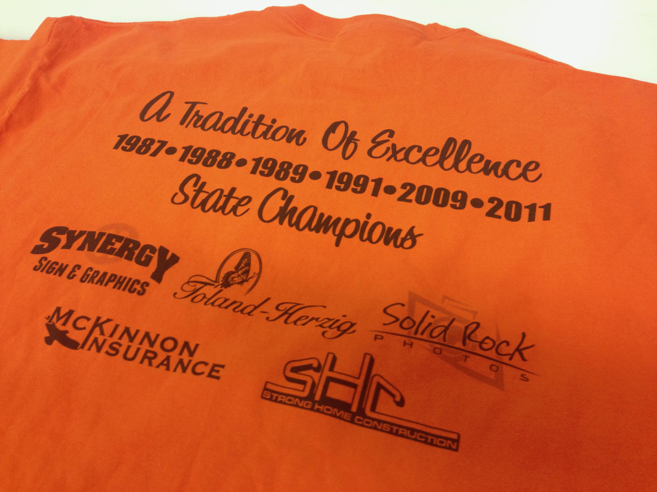

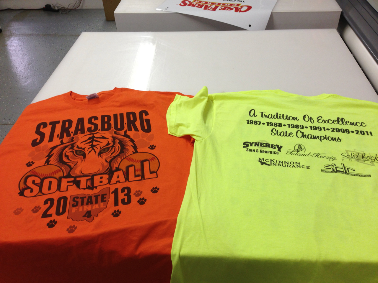

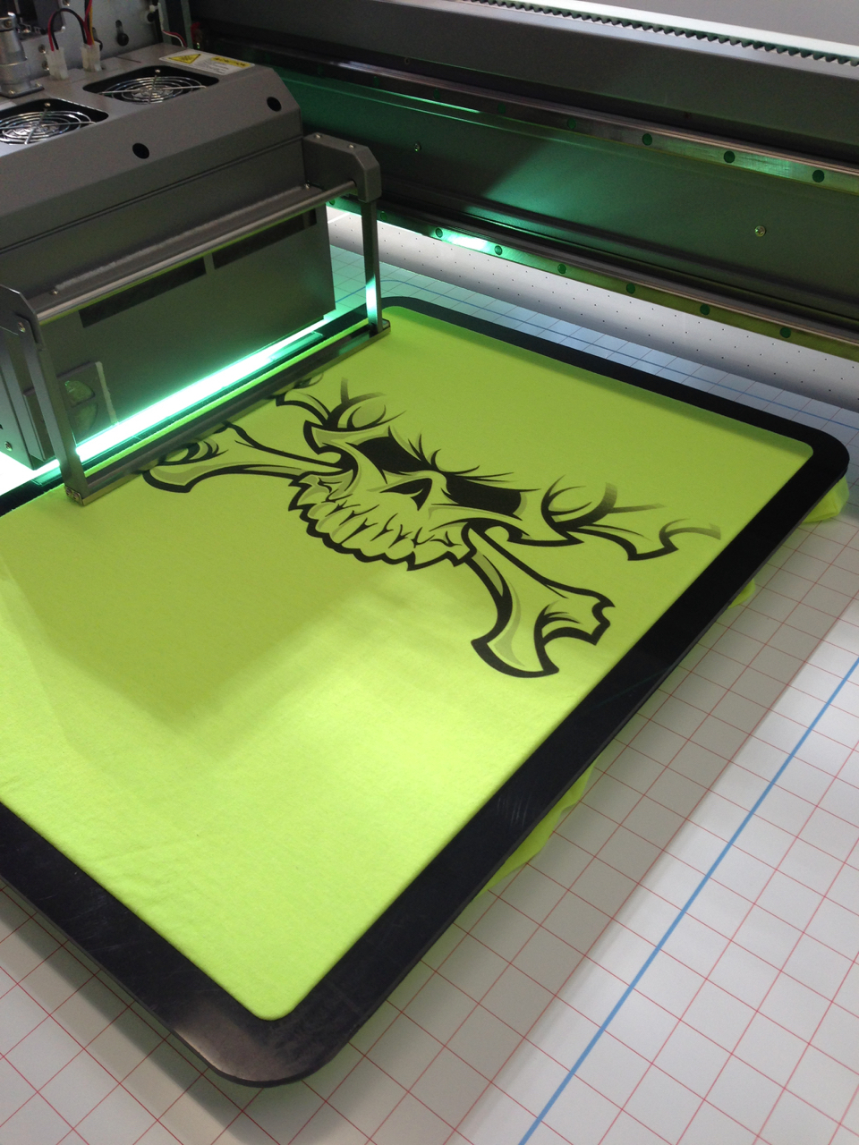

I beg to differ. While not the ideal situation, it does work and I have shirts printed on mine that have worn better than direct print. The key to laying the fibers down is pressing them before you print or using dri fit shirts that don't have fibers.

I've done the same thing. it works. comes out pretty nice too. just need to do it on the right fabric.

It loses about 50% ink load after the first wash though, so it still doesn't compare to a proper heat pressed/dye sub print.

Where did you get those platen jigs?
10sacer
Looks like a CET printer.
