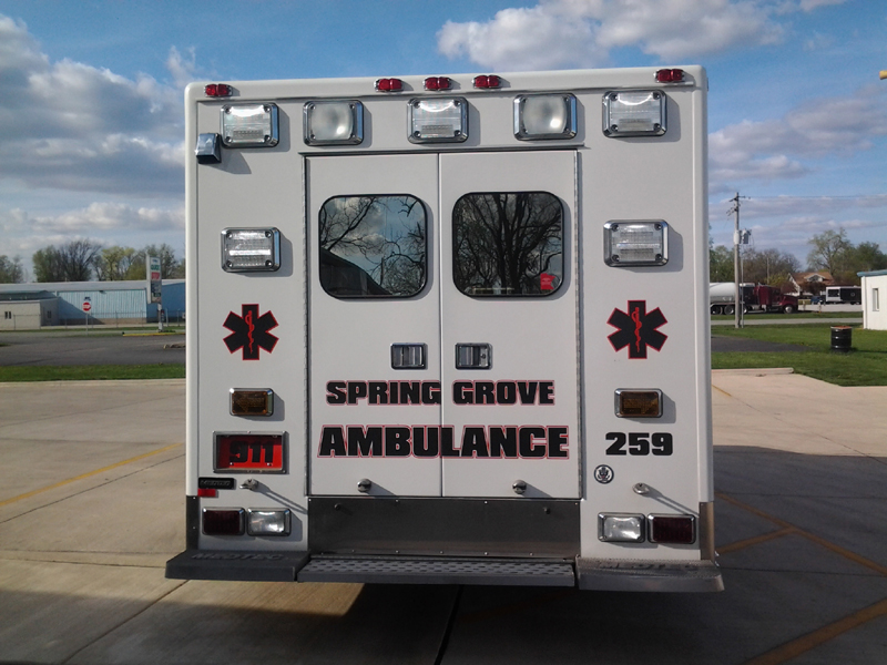

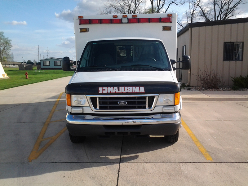

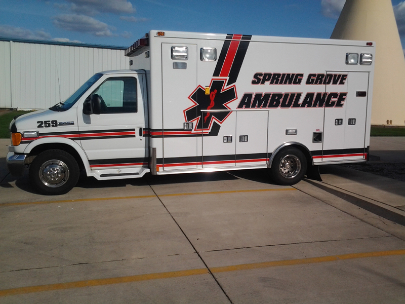

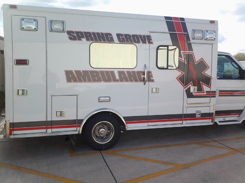

Okay, so I got a call from a local ambulance squad that recently purchased a used rig from another local community. This would potentially be our first ambulance job so before I write up an estimate I would like some opinions on time involved in removing the old graphics. Also any tips or tricks that we may want to consider would be greatly appreciated. I have no idea how long it will take to remove the old vinyl from this rig. I'm guessing if there are two of us working on it, we would be looking at at least a 16 hour removal job but I'm afraid I may be WAY off on that estimate. We've never had to remove this much reflective stuff (the red stripes and red graphics are reflective) so I'm kind of clueless. As far as estimating the cost of new graphics, that shouldn't be too much trouble, but then again, any advice is greatly appreciated. From the sound of it they want the same graphics only with purple reflective to replace the red and all of the lettering would be replaced as well. I'm leaning more toward removing all of the existing graphics and starting from scratch. Is it unrealistic to think that we should strip everything and start from scratch? I think they would like us to leave the black stripes and only replace the red, if possible. I just don't see it being possible to reproduce the star graphic with enough accuracy to be able to do that. Thanks for any input.

YOU CANNOT ACCURATELY QUOTE REMOVAL. There are just too many variables. I am doing an ambulance Friday. They had two contracts to sign. One of them was basically a blank check stating that they agree to pay me our shop rate * however long it takes. If you do it any other way, you are insane.
And yes - you should strip everything and start from scratch. Also, your contract for removal needs to CYA any damage to the paint that may be caused by the removal. Your contract for the new graphics needs to CYA in case there is damage to the paint from removal that you will be putting new graphics over.
