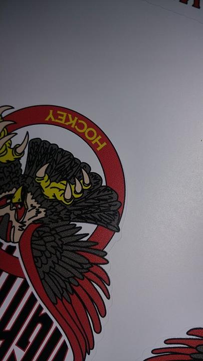

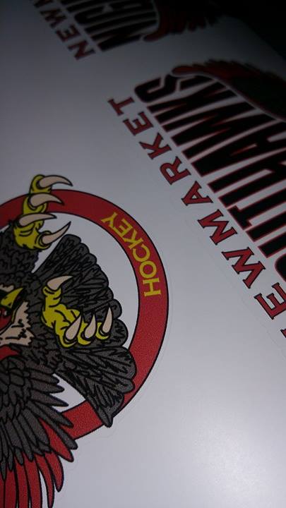

Printer is three years old never an issue.. the last few months we had issues with print quality and recently cuts drifting.. Print head was replaced last week due to a bad strike that well rendered it messed up.
BUt right now, when i print.. we are doing some logos for a client and if i print too many i get issues with cuts so i am doing one line of logos at a time.. 30 inch material logo is 5x3 inches, i turn the printer on send the print job, it prints and cuts the 8 logos perfect, Jump back into Versaworks hit print again ( Exact same job have not touched anything) well now that print job prints and cuts but cut off, if i sent the job a third time it would be off even more! BUt if i turn the machine of, and on again let it run through its thing and send the print job it prints and cuts perfect.. So basicly right now i am printing 100 logos 8 at a time turning the darn machine off every time.
I have done the calibration.. done the print cut calibration got it so it does that test perfect.. and it prints and cuts the first job perfect.. its when i do the next print job its messed up.
Anyone witness this or have any ideas on how to help?

Thanks everyone, SO it seems that during a service something dumb was done.. I had replaced the rollers and still same issues.. exactly the same amount all the time.. if i printed a row of logos worked prefect printed two rows the second row was off by 1mm.. did three rows the third row was 2mm.
So decided i would pop it open thinking well its out of warranty and two maybe i can see a missing tooth or something. removed the front pannel to find this!!!! Seems before repacing the print head we tried a print head soak and after it soaked over night i ofcourse turned the printer on.. ran a cleaning before i remembered i had the drain to the bottle still pinched off :( Which blew off some cap on the lines and well as you can see from the image hosed down the inside of the printer!!! SO made my own cap no more ink spraying issues.. However i must have had just one dab of ink in the right place on that large disk wheel thing with the sensor attached.. as i took some 99% rubbing alcohal and cleaned it up.. and now the printer is working flawless again.. perfect cuts every time..
So if anyone ever happens to have a issue that wheels did not fix.. check to make sure this thing is clean! The service tech said it made no sense as it should have given a read error.. which it did not.
