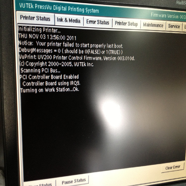

IT was working fine until one day, one of the glasses that covers the lamp broke. We kept printing for some days (very few meters) until the lamps suddenly turned off while printing.
So I called a technician (not certified) and he did a maintenance to the lamps and to the power supplys. He cleaned everything and put everything back in order.
Now when I tried to turn the machine on , it freezes when the turning on sequence starts and doesn't run. I am attaching a picture at the position where it sits and freezes keyboard and mouse and sits there.
Hope you can help me my friend,
Thanks

That glass that broke is actually a Quartz filter and pretty important to proper curing. First of all that should be replaced properly.
I would suggest calling EFI/Vutek support on the phone and speaking to them about it. Speak to Alejandro about settings on the Mobos I think. Could have an issue with some settings for some reason or could be a controller board that is fried.
ellsmako
First off , WYLDGFI is correct of course about the Quartz , heat mirror, secondly do not print without them. third you may have over heated the lamp assembly and fried the thermister ( thermal fuse ),
It may sound strange but with the machine off tap the three large white contactors in the power cabinet with the back of a screw driver . then start the printer, when those contactors age the can stick off ( although) it may look like they car active. If tit starts then either diagnose which one or change them all.
