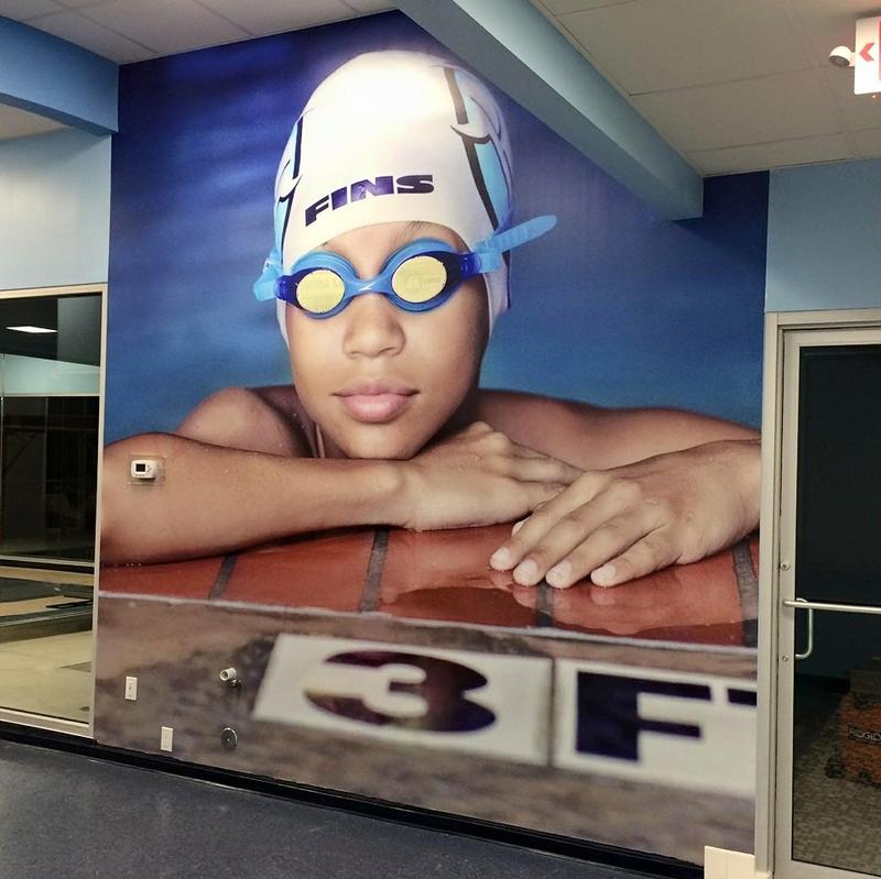

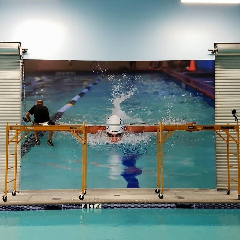

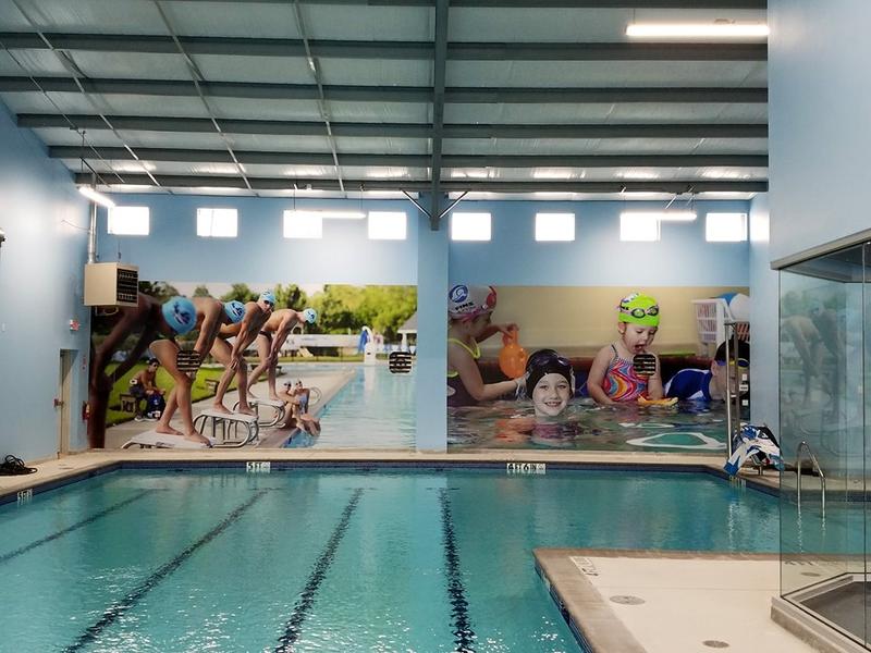

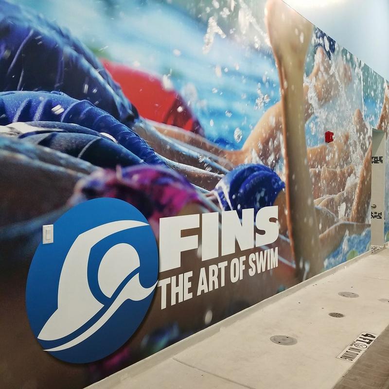

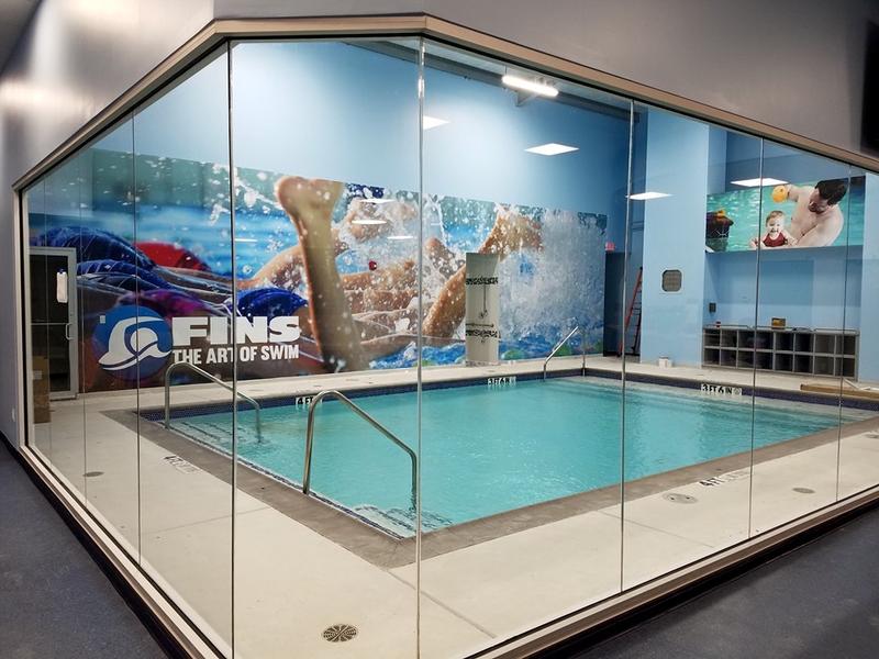

UPDATE!
We completed the indoor swim school project a couple of weeks ago and I got back in to take some pictures once construction was complete. The murals turned out perfect and are holding up better than I could have hoped in the harsh, hot, super humid conditions. The client is ecstatic.
If anyone finds themselves in similar situation, here are the details on this project.
The wall were painted with a Sherwin Williams product in a satin finish with no texture.
To ensure good adhesion and no paint failure, we installed a test panel 144" x 48" and let it sit in the hot, humid conditions for about 10 days. There were no signs of problems, failure, paint peeling, etc. Everything looked perfect, so we proceeded with the rest of the project.
We used 180Cv3 / 8520 printed on a Roland XR640. We let these prints cure for a couple days because we had the time and it couldn't hurt to be safe. The walls were cleaned. Vinyl went up quick and easy, heat set and rolled. We added edge sealer to the top edges out of an abundance of caution. After a few weeks and over a month since the original test panel was installed, that vinyl is stuck. There are no signs of failure, lifting, bubbling, etc.

Looks great. How long did the install take you?
Thanks! Two guys on the job site for about 2 days, give or take. Big wall installs like this with very few obstacles actually go pretty fast. It's heat rolling everything that takes forever.
