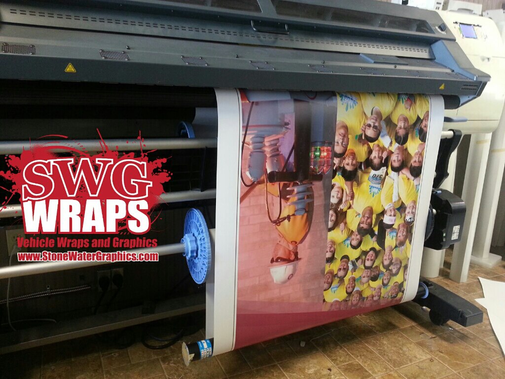

This is super old, but when I used to run a specific brand of poly-something for tradeshow graphics, we used to put tubes of construction adhesive in the balance bar thing and tape the ends so it wouldn't slide out. That kept the material flat when it ran through and didn't buckle with the heat. ha
This was on our 25500 btw.
