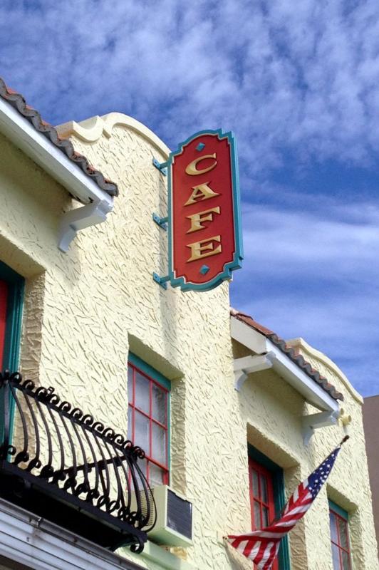

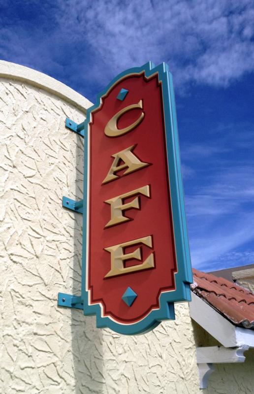

Just returned from putting this one up finally. Damn permit took three weeks to obtain. It sure does compliment the building and the client was beaming from ear to ear!

Very NICE job, I like the color scheme.
Can you share how you made it?
What all it took too make, any photos of construction?
:rock-n-roll: :clapping:

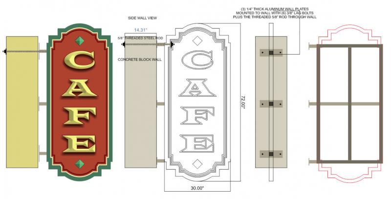

Here's basically how it was made. 1.5" x 1.5" welded aluminum square tube internal structure. Covered in Polymetal with a 1/2" thick PVC raised border. Letters are HDU. Paint is all Matthews single stage urethane.

Very nice. I appreciate the through-wall mounting too. I start and finish stuff before the permit is issued all the time too. It shows both your confidence in your design and understanding of the code, LL requirements, etc. It also shows that you are charging enough to do the job (cause your cost to do it should have only been a small part of what the customer pays anyway and was likely much less than the deposit that was already left). That's my thought on it anyway. Excellent job Bob!
