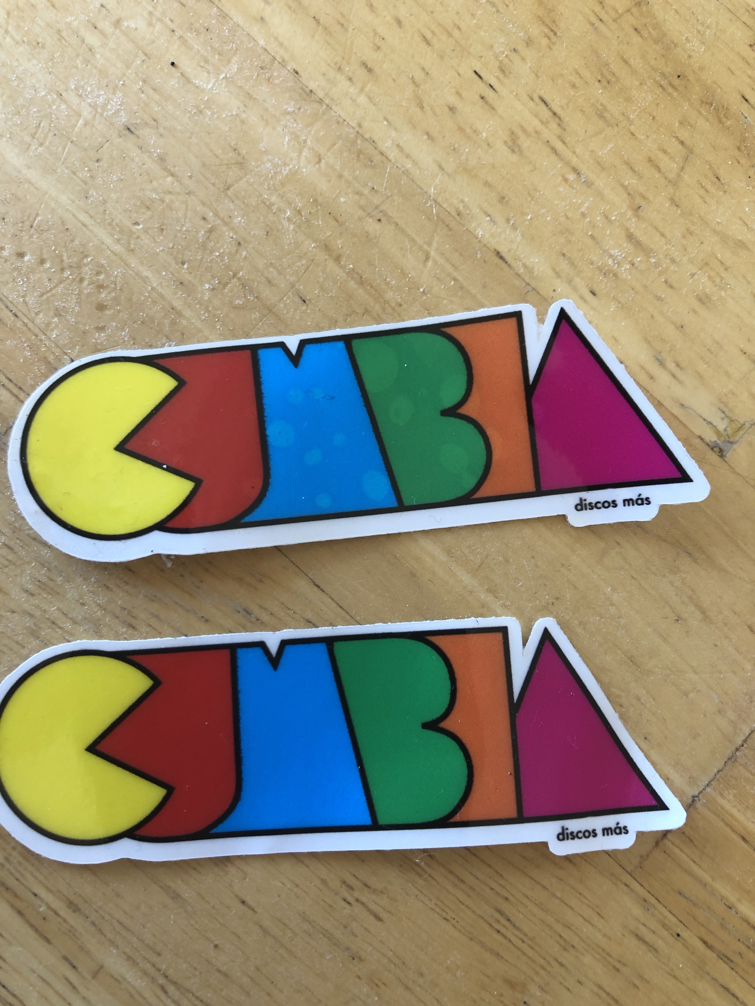

What kind of Clear vinyl are you using? I'm having problems with "cut thru" decals using an Oracal clear vinyl. I usually use General Formulation for my regular decals because of the non branded #90 liner. Excellent for kiss cutting and cut thru decals. I attached a photo of the result of me cutting on the clear Oracal vinyl.
All 500 were skewed in the same direction. This is after I ran 10 other jobs with the General Formulations without a hitch. I also always checked my equipment, printers, cutters, Rip and I even turn off the computer that controls all the equipment. I think it's the backer on the Oracal clear. What do you think?

I have used oracal 210 in the past with no issues. Can it be your cutting pressure? Maybe the other lam you used was thinner. Pressure/new blade will do wonders

Yeah I was thinking I may have to reduce the pressure on the cutter. The funny thing is I ran a 20 piece sample and they cut damn near perfect. I then ran a 160 plus run and they all came out skewed. I am also using a Gloss 210 Lam over the top I forget to mention that. I may also have to check my blade depth maybe that's a issue as well. Fairly new blade.

I've had issues cutting heavier films too fast. My guess is the extra weight caused it to slip a bit here and there, slowed it down and it cut perfectly.

Are you using vertical compensation on the HP? Does graphtec have a vertical compensation method? I bet the Orafol vinyl is stretching more than the gf vinyl.
