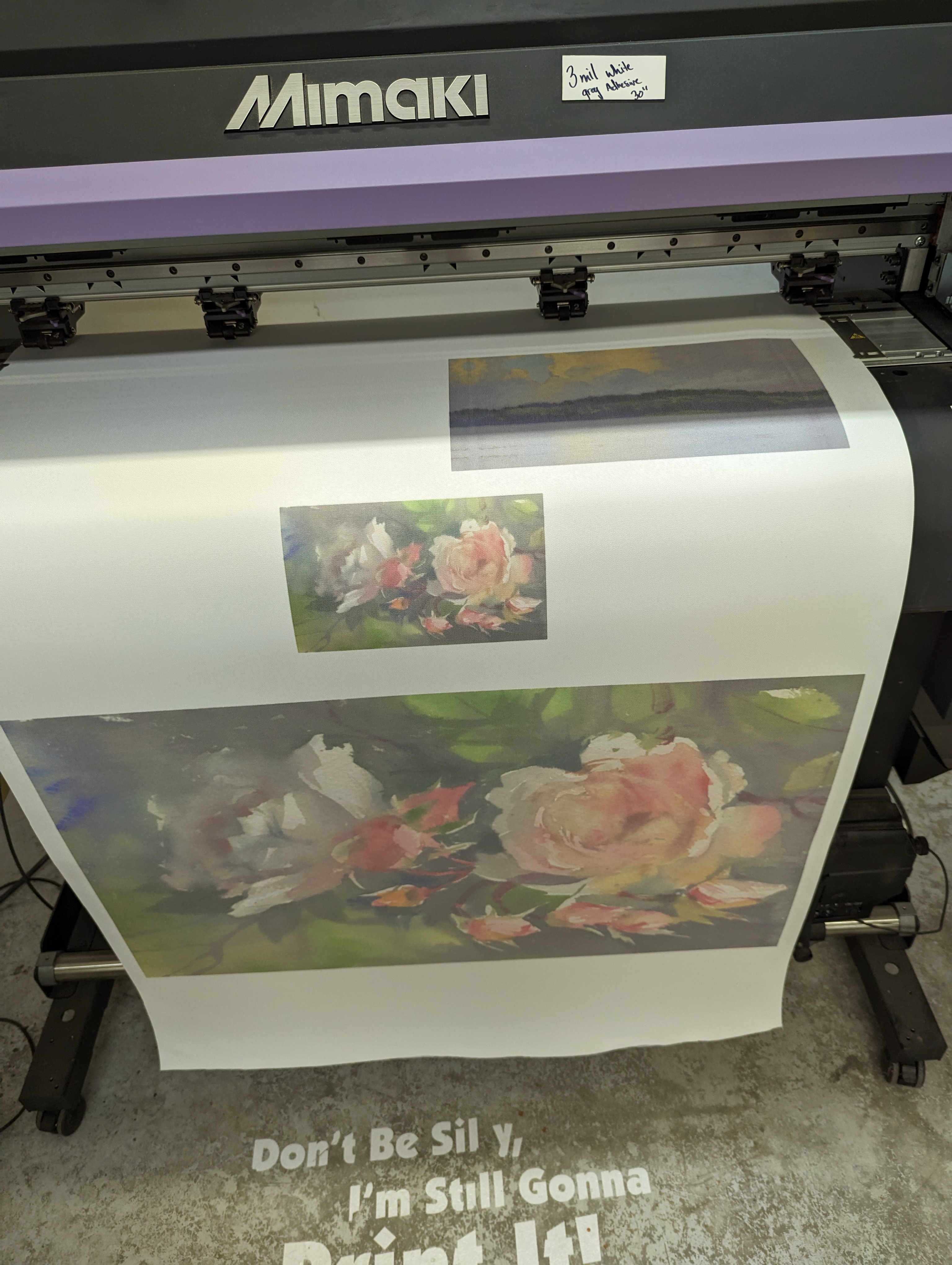

Guys i have really bad issue. i have a printing machine and i use "ultra print" to ripping image, then using printexp hosonsoft to print the ripping file but if i print image, the size is always less.
for example, if i print 77x107, the printing size probably will be 73x104 or something different but always less.
how can i get the print what i exactly which size i want?

This is odd. Although, I was using an HP latex at the company I was working for, and the same issue for doing traffic signs. Ultimately , since we were printing on prismatic film, it was the printer profiles from . The width of the prints were fine, but the long ways weRe short. I also 2ould adjust the print file size in the Rip software
