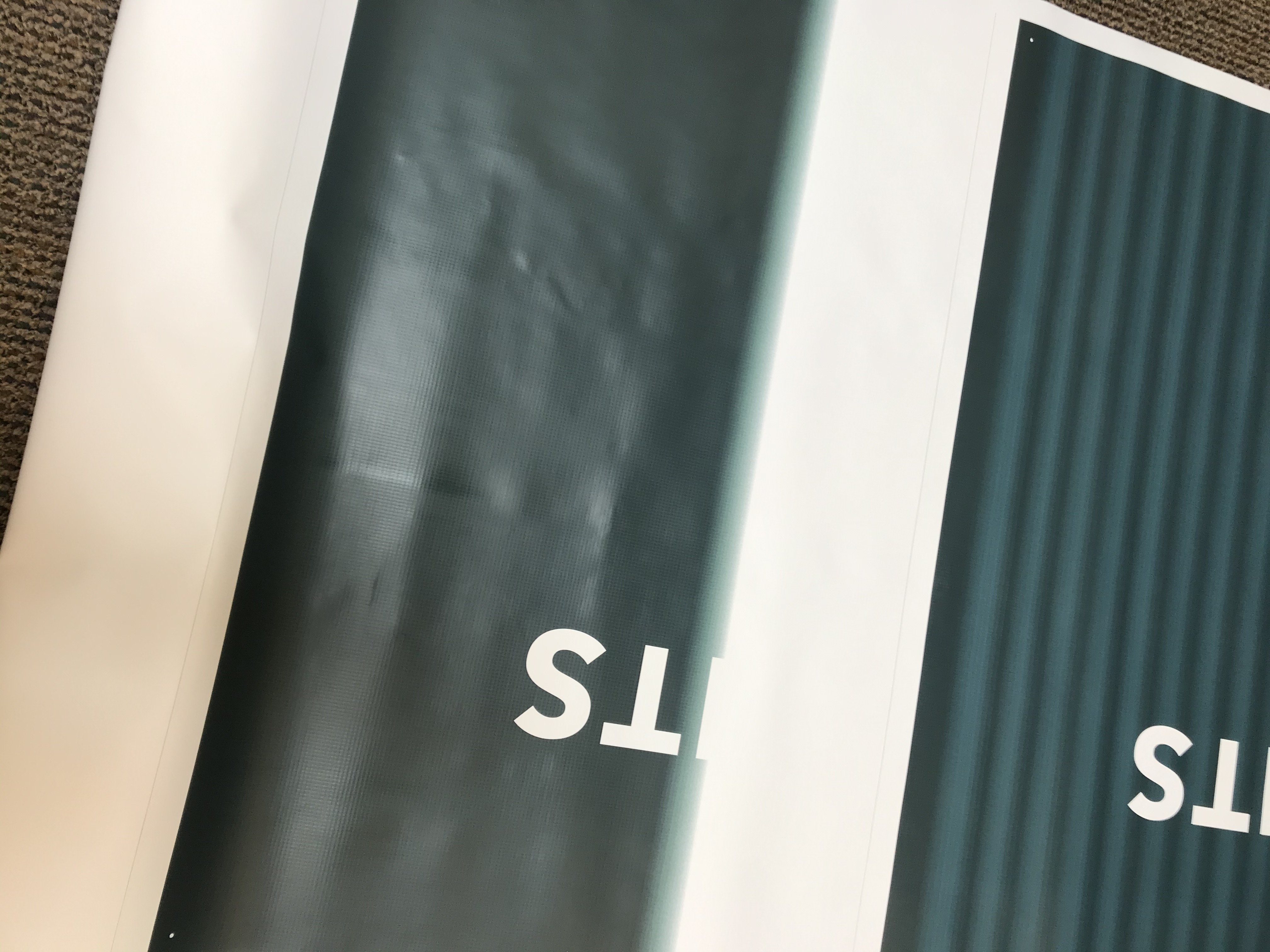

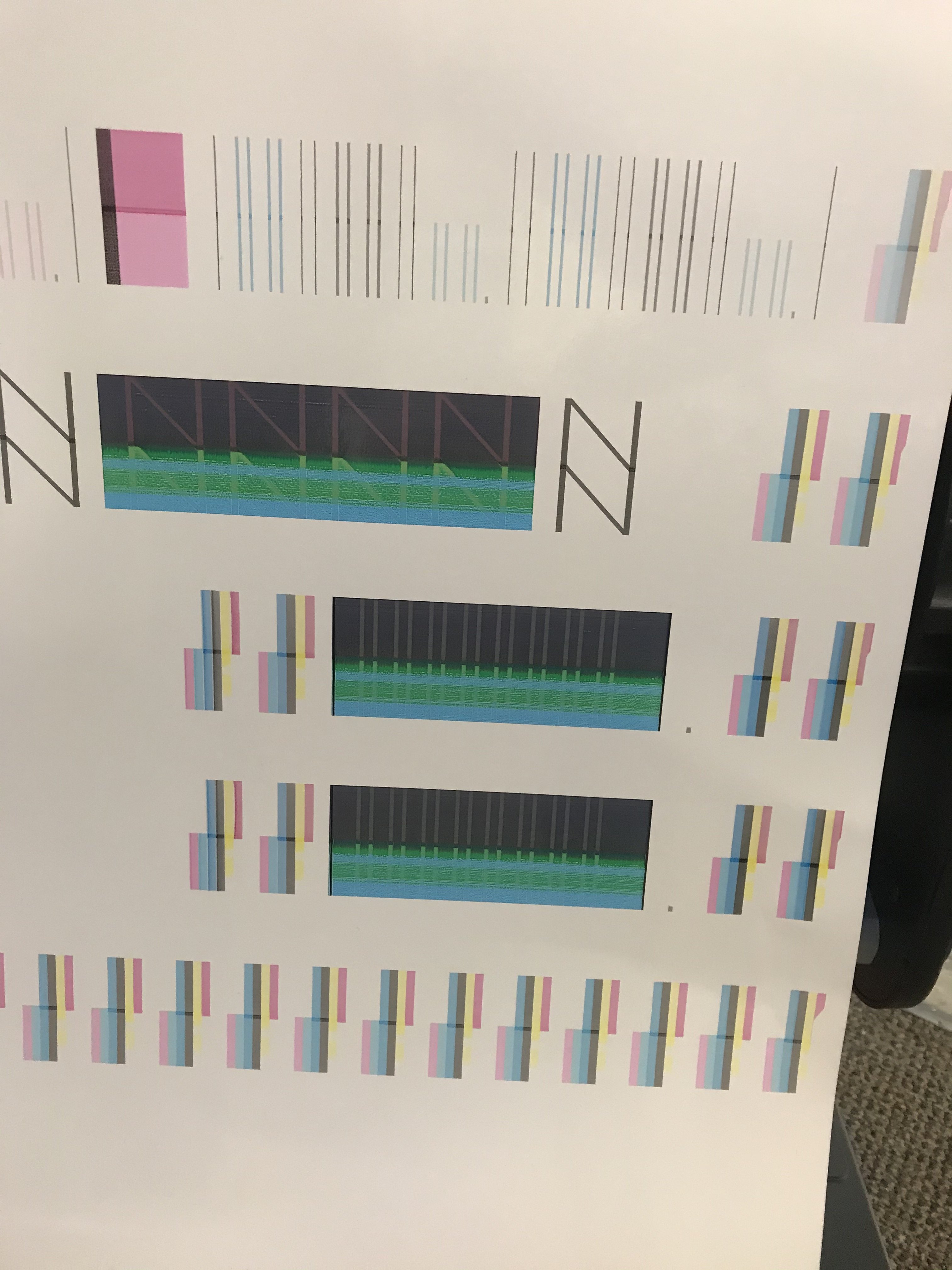

Now to complicate matters, when I went to print a non-color critical banner I got the following out of the printer. It was printing fine, but I canceled to reposition the banner in the middle of the roll. When I restarted It started doing the zebra stripes. When I printed the test, I got the perfectly healthy looking test found in the second image.
Yikes - try printing those solid bars much larger. Crop the image in Onyx if needed to just those bars, then make them 3-5ft in length. See if that duplicates the errors at all?

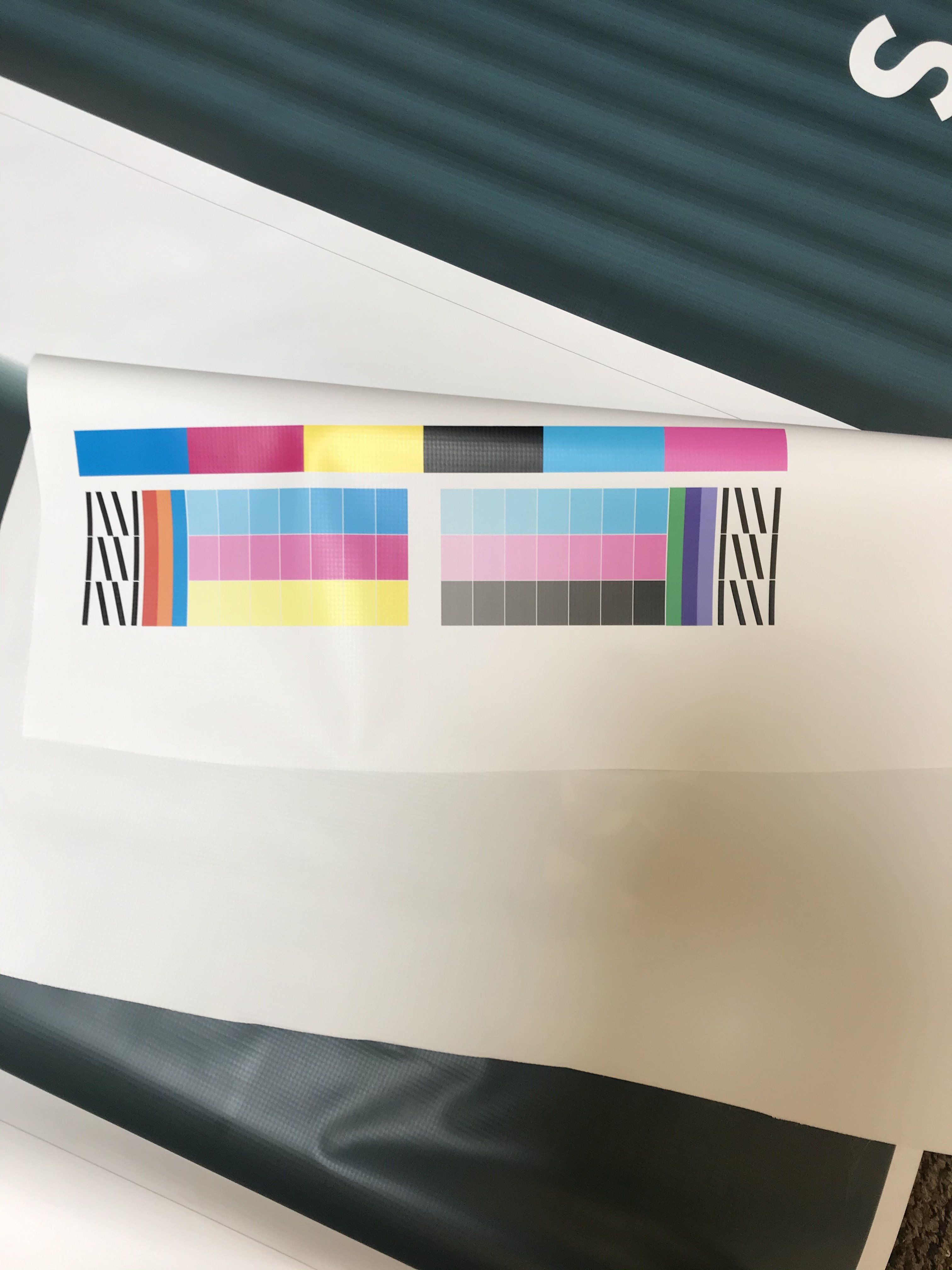

So, after giving up and switching all of our printing to our 570, one of its heads takes a dump. Appears to be the #7 yellow/magenta. Put two different, brand new heads in it and still have the same issue (photo attached). So - clearly not a head problem - maybe cable connection? Has anyone seen anything like this?
