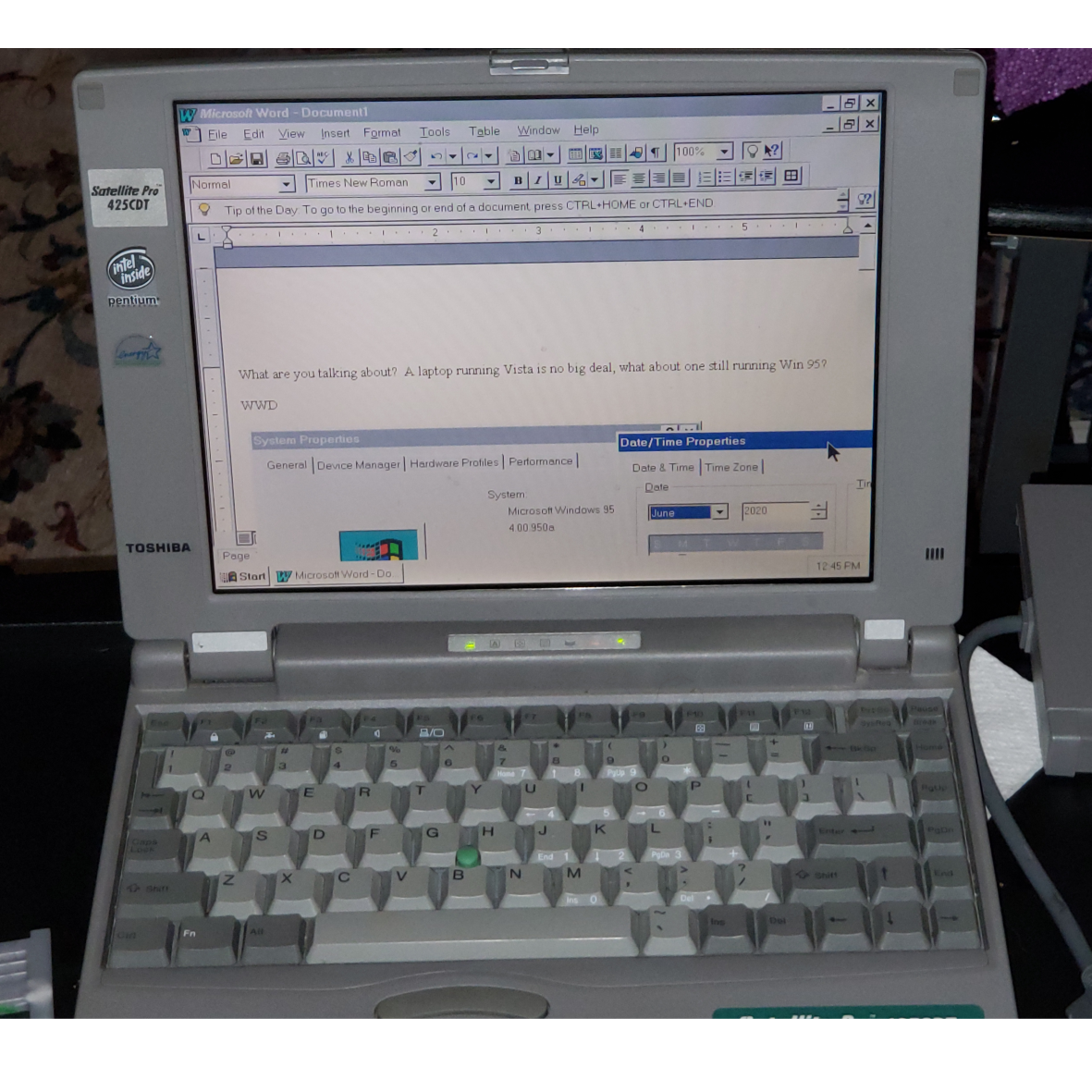

We still a laptop running Win 95 here. Not used for much though, but it still runs and runs pretty good. Pic taken today. Still handles the old games pretty good.
Built far better (like alot of things) back then.
GaSouthpaw
Profane and profane accessories.
Yeah, but Win 95 mostly worked. Vista was a pain in the ass from the launch.
WildWestDesigns
Oh yeah we all miss the Win 95 Blue Screen Of Death.
Ironically, Win 95 and Win 98 were far more stable for me then Win 10 is for my dad (and they were actually far more powerful, not in terms of computing power, but in terms of what the user could do with them type of power). I actually never had a BSOD on any of the 9x line (but I only had 95 and 98 (not SE, original 98). Now Vista, due to it's resource hog propensity, it BSOD all the time. Although, ironically, I prefer Vista over XP (go figure). Truth be told, Vista is actually one of my top 3 of Win versions (and I do still run those 3 in a VM for nostalgia purposes).
