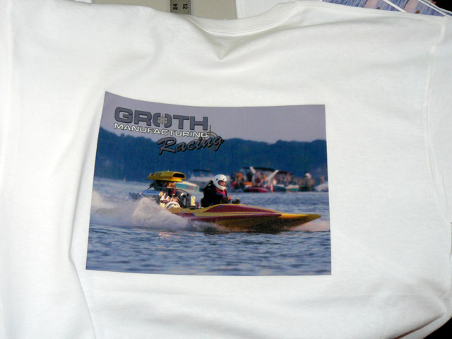

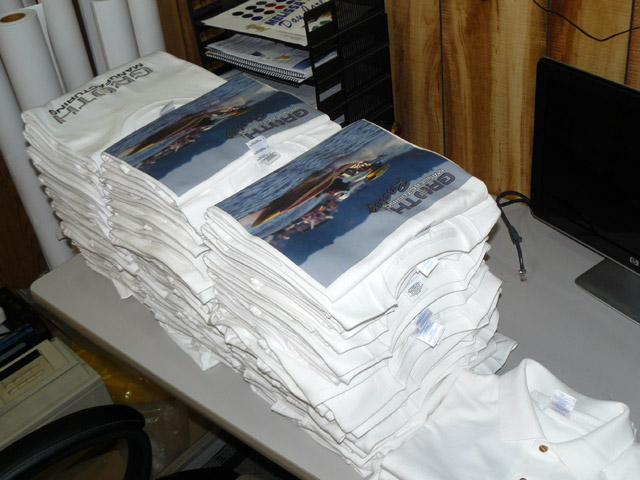

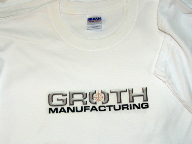

We are 100 full color fronts & 25 full color photo backs into it using T-Printz Light we ordered from BigFish and still going. Need a :beer LOL. Will give a full report once we finish. Gives a great transfer for full color photos.
Here's a couple pics.

After doing some brief test prints and applications, I just printed my first roll of T-Print light 24x50 and am now into the second one. We plan to start pressing in bulk tomorrow. The one thing is the material came with no suggested heat temp, time or pressure setting and we couldn't find anything on their website so after some testing we found that 35 seconds at 375 deg. seemed to work fairly well on 100% cotton. Anyone else have any suggestions on what worked for them?
