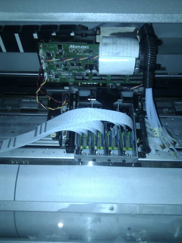

I have decided to buy MIMAKI JV3-160SP and completly rework it. I have spent lot of money because there are changed every important parts. For example i have changed: 4x Printhead Epson DX4, 4xhead plates, head springs, assy head cables, 8x dampers, 4x plastic damper holders, 2x head carriage bearings, all ink tubes with all fitings and seals, wiper, wiper holder, wiper bracke, wiper motor, assy motor, 2x ink pumps, 1x waste bottle, 4x cap tops, paper width sensor, wiper belt.Lot of parts has been cleaned: head carriage, front and back heater, front decal, fan coolingi have dismount
