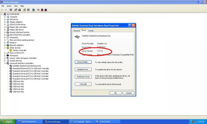

It is showing up and I do have the same version as you. I have tried to update the driver version but it keeps giving me errors as in the screen shots in the above posts.
With some phone help (Thanks Casey), come to find out that I may have a failing hardware issue.
Everything looks as it should. I could not open Flexi 10 or 10.5 once I "repaired" windows. I did not do a full format and windows reinstall, I just repaired the files needed to get windows running again.

The hasp key will not uninstall or update. I plug the key in and I hear the ding and the green light comes on. Both flexi versions 10.0 and 10.5 are uninstalled at this time

From your Device Manager screenshot, it looks like your chipset drivers have not be installed. Those are important. You can probably find them on a "Drivers CD" provided with the computer. That would be my first step for sure.
It looks like your hasp drivers are loading ok, at least from the screenshot. It may be worth re-installing Flexi 10.5 to troubleshoot more. Well, after installing the chipset drivers, that is.
