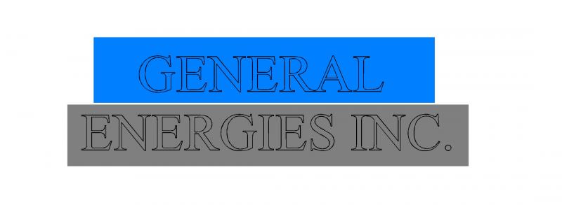

I understand the .08 to .12 outline around the letters, but in this particular case, wouldn't this be easier?

I was talking about TWO issues, first as mentioned, very hard to contour cut with 100% accuracy, I enlarged the OP image to 24" wide and at that size the verticle stroke on the letter "N" is LESS then 1/10th of an inch wide, hard to cut that dead on.
And the second part is, printed vinyl, laminated and contour cut that thin is likely to have the edge of the laminate start to PEEL, or curl up because there is not a large surface of adhesive, IMO.
Again, just my thoughts, you all can do whatever you want, it just doesn't float my boat doing this on an image that THIN ...

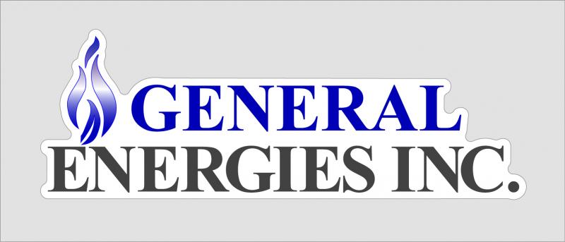

Edit:..... Bill, not sure what you're asking, but.... If these were all print & contour cut, vs. die cut vinyl, I don't believe the customer will care or understand if we gave him an explanation of each process. He gave us the specs that these only have to last upwards of 2.5 years. Whatever process is our choice from there on out. Either way will be individual cut letters, being blue and gray.
Come Monday, We will explain the benefits of going with a solid decal.....and how we won't even charge him extra for it. :ROFLMAO: (see attachment)
