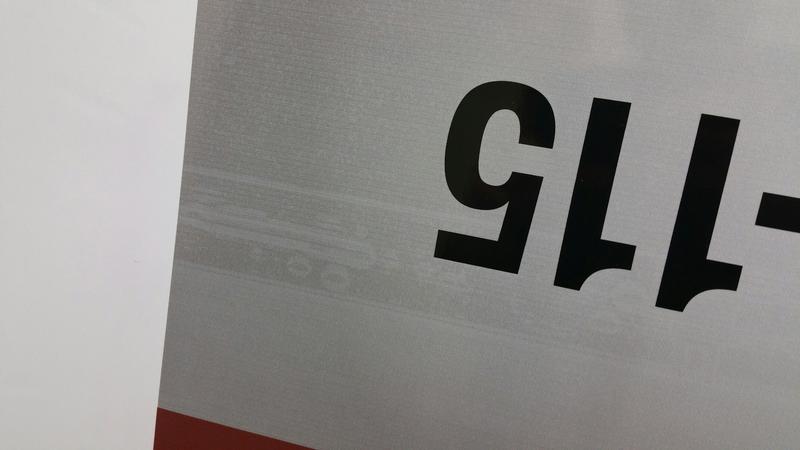

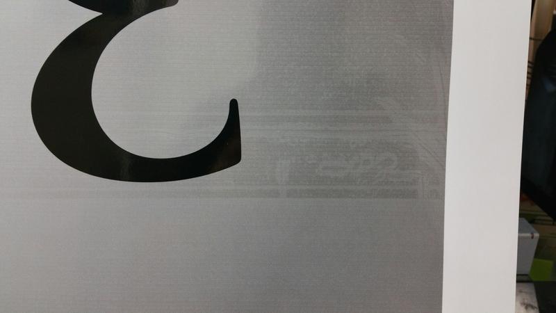

so this is the second time this has happened. First time was a brand new roll, same issue. Print looks all "speckled" or like it has freckles. This is mostly recent. We will print a whole roll fine, same profile, next roll, it started this issue. I printed 70' off this roll, next day, load it up to print some solid dark blue prints, started this problem. I am starting to get frustrated. We have printed numerous rolls with our 360 and never had an issue. I did all the cleanings, alignments, diffferent profile... Tried a IJ35 in the machine, and it printed beautifully. Is this something common or am I doing something wrong?

a77
I've given up trying to print on 1005 with my eco-solv. All other media, including other avery media, prints fine. I haven't seen that, I get mottling in any solid colours. Show your supplier and they'll give you another roll, and then it will likely happen again.
scott pagan
looks like contaminant on the surface of the vinyl causing the ink to "fish eye" away from the problem areas. your supplier should be able to work this out with you and Avery. check lot #s on labels and see if you have another roll outside that group that prints better.
Kwiksigns
wookie
this is what they are doing. It is being taken care of... but two rolls... it's so easy to install and holds up great... but I don't know if it's worth my headache
Artworks
Artworks
Definitely a media issue. I am switching medias because of it. It has happened on my last two rolls. there is a fix. Roll the media out on a table of take up reel and wipe the entire surface that you will be printing with rubbing alcohol. Prints come out clean as can be. Pain in the @$$, but it works.

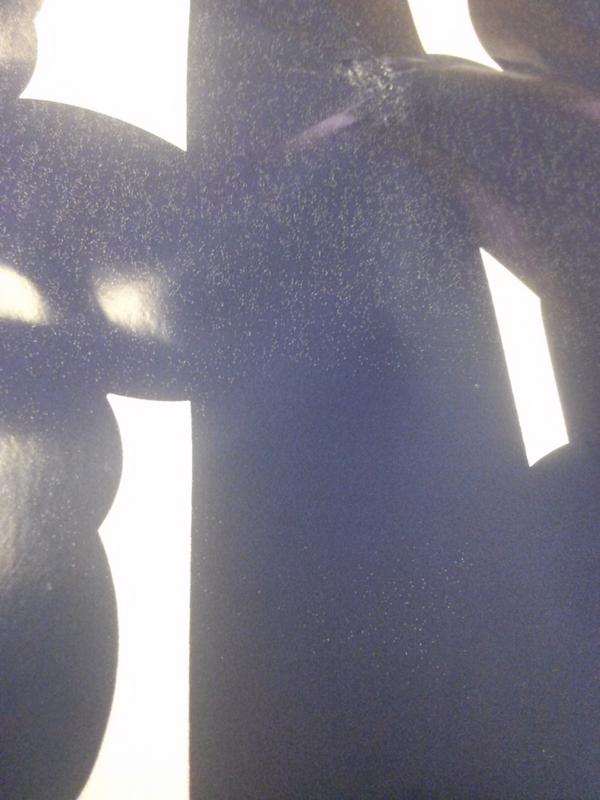

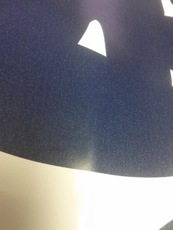

Desert_Signs
Just happened to me yesterday. Luckily it was at the very tail end of the roll...

Kwiksigns
wookie
Avery sent me a free roll of some color change that I needed for a wrap. I also got refunded on everything. As far as I know, they are aware of the issue, and so Avery and my Grimco branch were very helpful in getting me new rolls and taking care of the issue.
