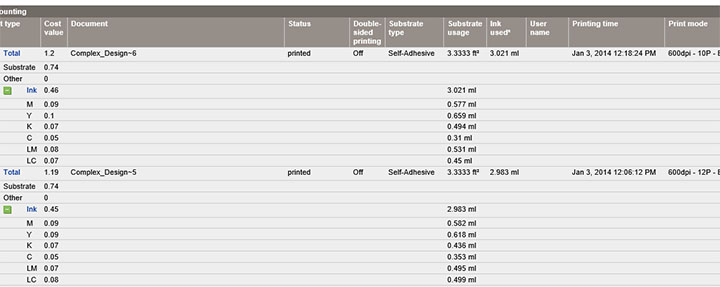

    As you can see from the attached image, there is almost no difference in ink consumption (1 cent worth) between 10pass and 12pass print modes on the HP Latex 260. It will print at a lower throughput at 12pass as you said. This example is holding constant all other variables (ink limits etc.)
