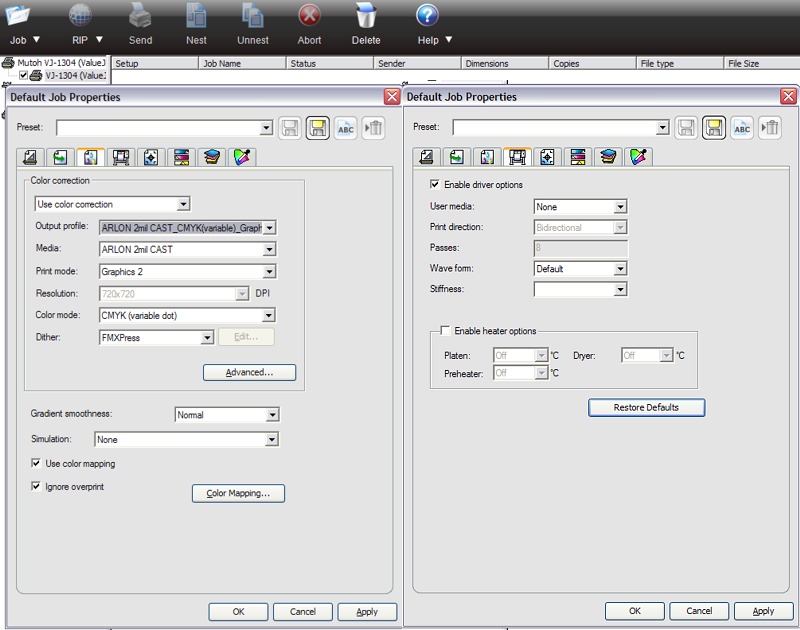

    Sorry for the excessive requests for hand holding here, but I have some more questions.
    I pulled up the Arlon graphics 2 profile and looked it over.
    Under the printer options the wave setting is "default" and heater settings are not filled in (listed as "off" in all 3).
    Am I doing something wrong here?
    What settings do you use when you run this profile on the 180C?
    thanks once again.
    wayne k
    guam usa
    ps
    I tried to attach a screen cap of both open dialog windows in the program manager but uploads are not working for me today.

    Now that Fred has fixed the upload here is the screen cap I was trying to attach to my last post.
