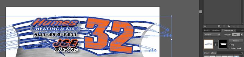

Interesting. Well would you be willing to show me how to create the spot color for the contour. I mean i know how to create swatches and spot colors and all that just didnt know if there was a difference since it was being used for a contour cut.
I guess my only issue would be about the contour outline b/c i have 2 clippings masks in the design.
Image attached.

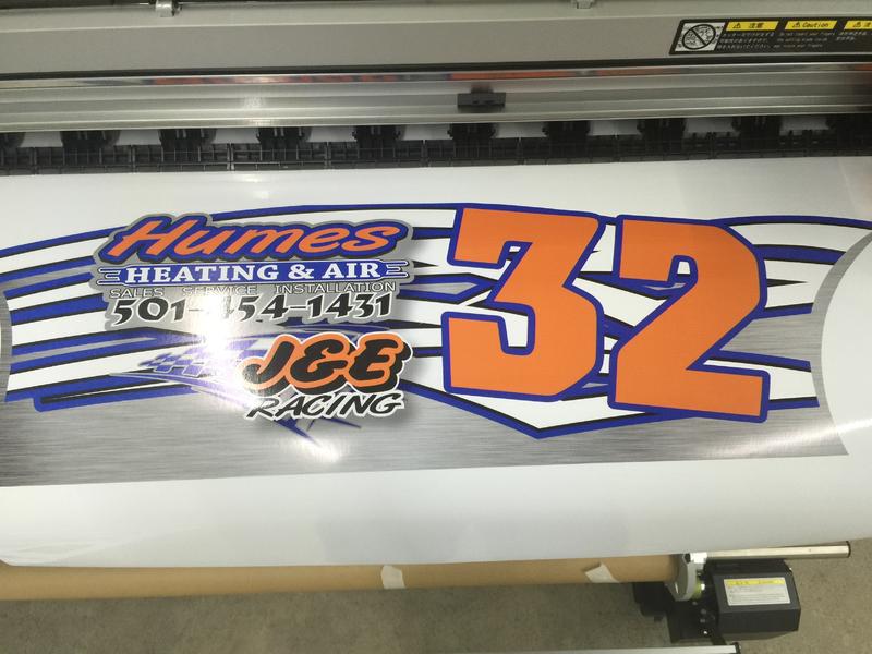

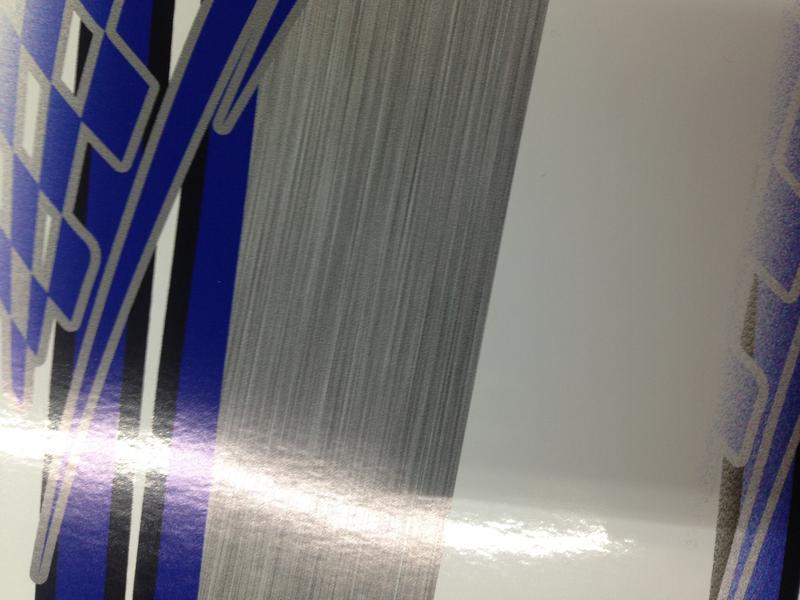

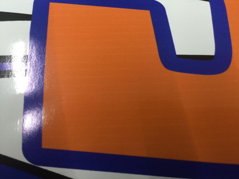

So i changed the mix on the black and i read to change the driver options and the weaving effect to wow3 so i did. I also converted the file to a raster before i saved the file and opened in flexi. Now i know i was told i could create and send the file directly to PM but i would rather get my kinks worked out first with the file directly in flexi. I do have some banding on the colors tho. Any idea on removing this. One of the delivery trucks that we had done a few years ago by a wrap company has the same banding on the solid colors. Also anyone that has had training on the 1324 be willing to take a minute and talk. Have a couple questions.
I also have the profile set to the material we are using. I know some have stated to try other profiles but i would go broke trying repeated profiles using ink and material.
Also when i downloaded the profile pack from flexi it only shows 2 of the profiles for the material i am using.

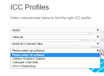

Also when i go to oracal site to download a icc profile it doesnt list anything for flexi?

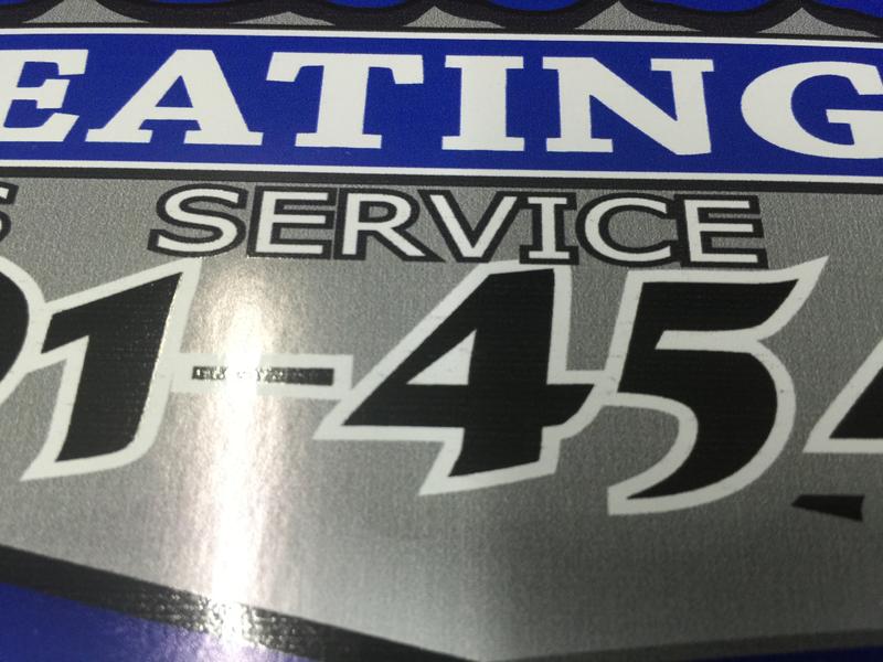

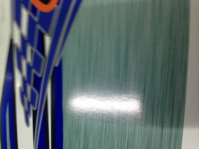

Ok so new test. When u print in vector without rasterizing my letters look great with no tiger stripes or banding but the background that is a JPEG looks kinda green. When I rasterize n illustrator then open in flexi the background looks like it should color wise but I have slight banding or stripes n the letters and colors.
i can change to quality 2 that is 1440x1440 but it still shows slight banding or stripes. Also tried using wow3. Fine and fog3 and gone and fuse 3.
Should I not be able to print vector and JPEG. Combo or will I always have to rasterize my designs to print and be ok with the slight banding.

You can look at the images that I posted earlier and noticed that there are two variations of the orange number. One of them looks like a bunch of little drops and the other has tiger stripes or banding. The one with the banding actually looks like a better print than the other does but the one that looks like little drops is more uniform. The one that is more uniform is a vector that has not been rasterized. The ones with banding are the files that have been rasterized but all the colors are accurate after being rasterized
