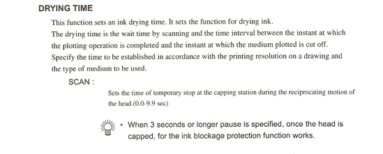

    Artbot,
    I decided to have a quick look, since I never look at the manual, and who knows but what it might benefit me some day.
    On page 4-8, "Drying Time" seems to only represent a time adjustment between print completion & an "auto-cut" feature, should one be in use...
    however the heading "scan" looks as though that might delay each pass.
    I'm not sure, but figured I'd make sure you knew about it in case it does help.

    i'll check that out. i think scan deals with if the head makes full passes or short passes where possible.
