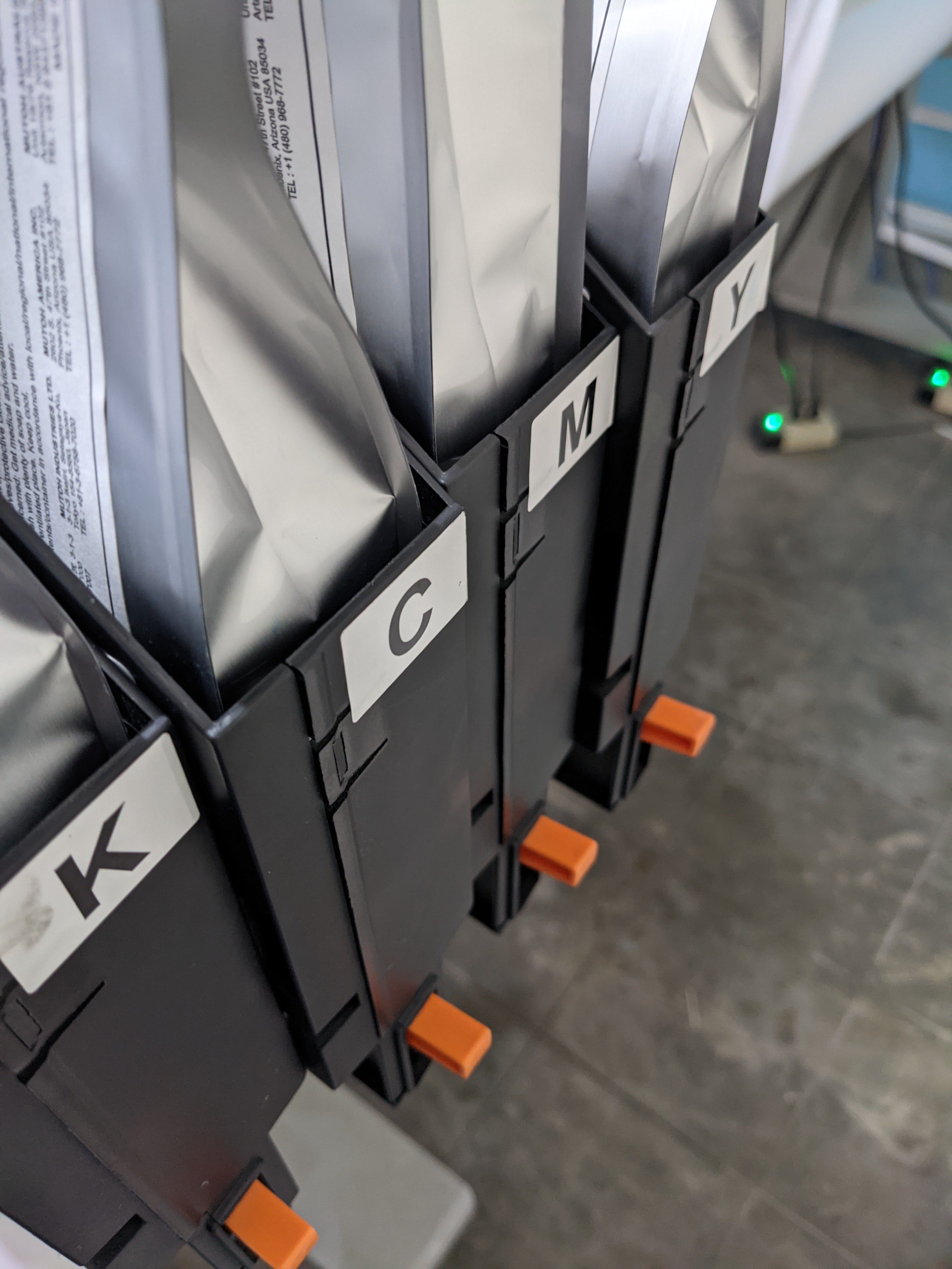

Need some help with Mutoh Ink Adapters. We changed all the Inks after doing a clean, and two of the 4 (CMKY) are not seating fully into the slot. Is this a common issue and what could be solution?
We have tried multple ways of Inserting etc, only thing left to do is open it up to see if there is something block the adapter from going all the way in. This is not first we are changing Inks but frst we are having this issue. Hoping its an easy fix.
See pic, C &Y are unable to go all the way in.

Try inserting the C & Y adapter into the B & M slot and vice versa just to see if the problem is with the adapter or with the printer itself
