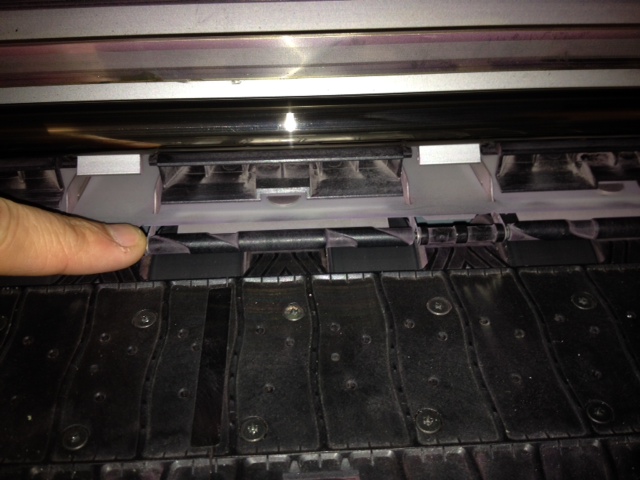

Try replacing the little black rollers that clamp the material to the platen. I was having this issue again on some banner. Replaced those things and it seemed to do the trick. Not sure if a coincidence or not? Someone else give it a go and let me know!

Peavey,
Would you mind taking a photo of those little black rollers? Just want to be sure that I am replacing the correct ones. LOL! I'm willing to give it a try, but I'm no tech. Capable of fixing as well as vexing, so I want to be sure! :Big Laugh

Here you go Suz.

Awh, Thanks!!!! So nice of you. Hopefully we can get around to doing a bit of maintenance soon, as I have some banners to do soon.
