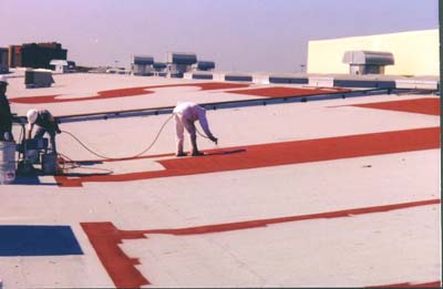

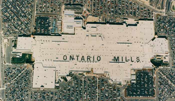

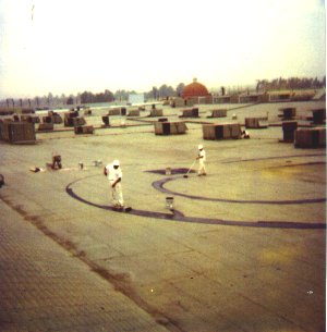

Si Allen
They must be crazy to think of using stencils!
Lay it out for them and let them paint it!
( For Jill :) )
Ontario letters are 75 foot and the sign is just under 1/4 mile long!
The Grapevine letters are 48 foot.
