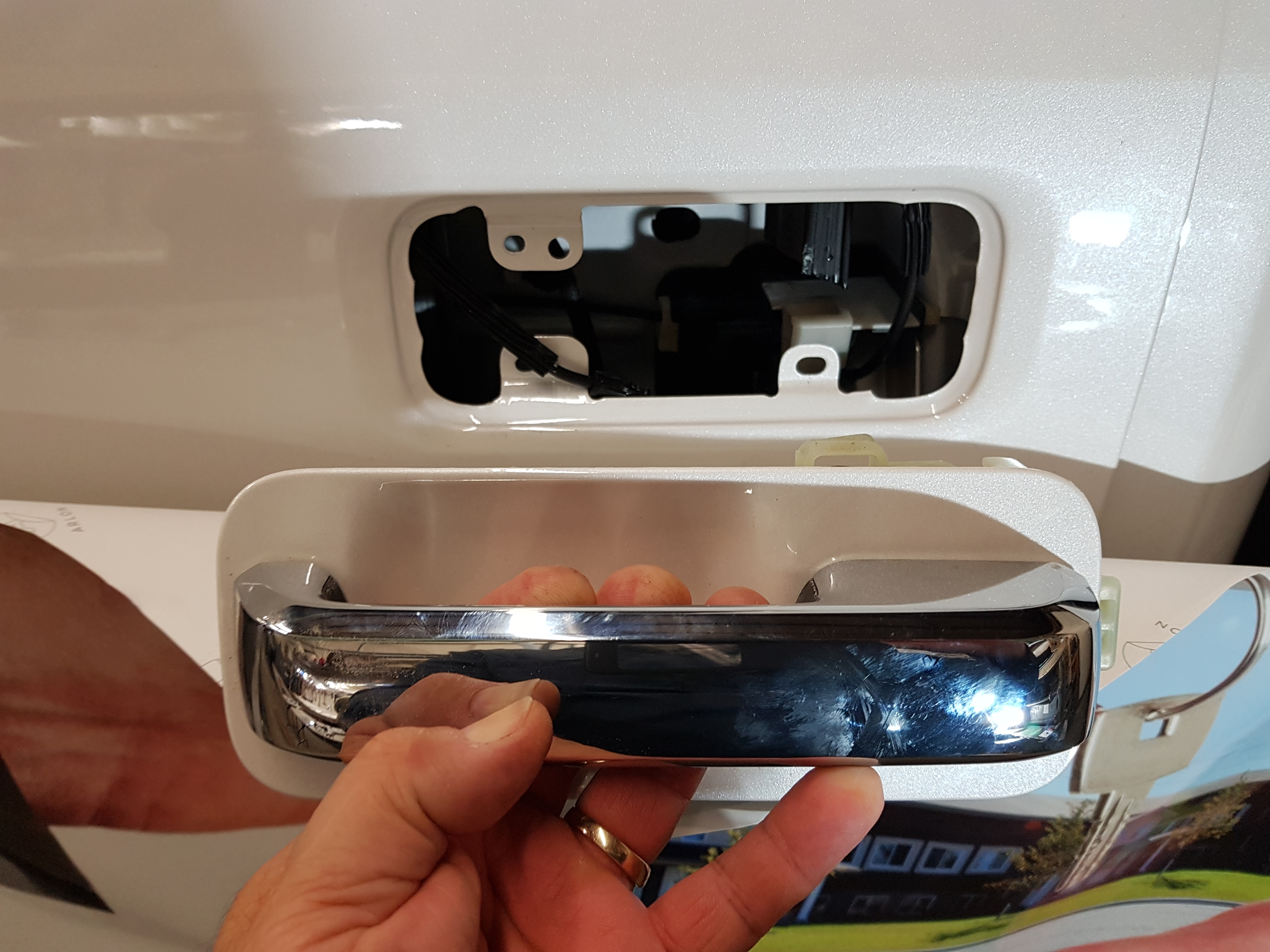

2019 Ford super duty F250. how do I remove the exterior handles so I can wrap the truck then re install the handle?? help asap!! I have done hundreds of different types of vehicles and they typically have a set screw on the inside of the door edge, which this truck does also, but it won't release and come out for the life of me!!!

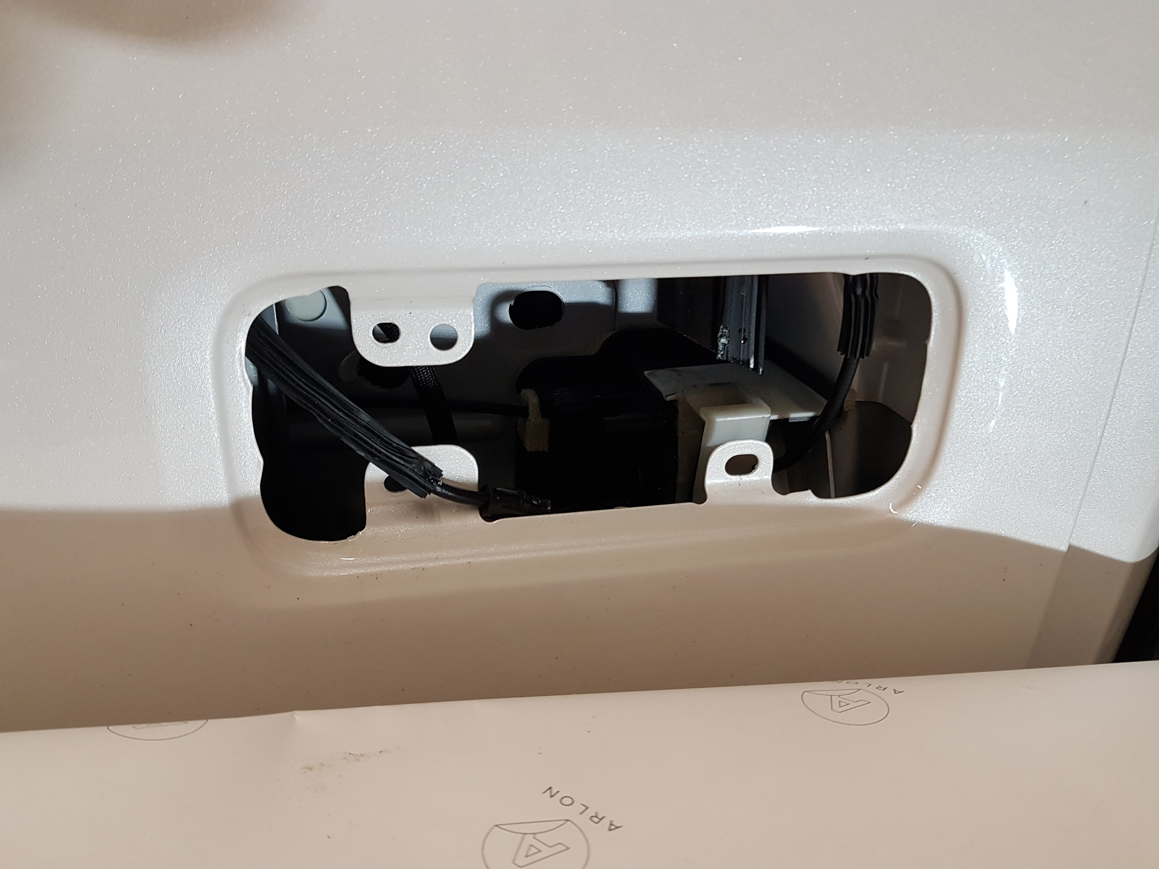

Yes. the dealer finally called me back and walked me through it. Even he said that the way these 2019 are , they are not the same as the older ones. As you can see in the photos attached, the plate is permanently attached to the handle. you need to completely disassemble the handle to remove this plate to be able to wrap it properly. Not a good design at all.
