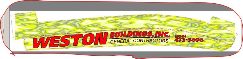

Can any one tell me why versa works seemingly will not take my wrap layout which is 240 inch by 54. It is cutting it off at about 200 inches. Is that versaworks limit? Im missing something here.
Jackflush
Gorgor
Pdf 240x50in. When I open it in versaworks it opens at 200x50. What do you guys use to print these 20+ ft. images? Some people are doing 35 ft wrap prints. what do they use to getr done? Ive looked at documentation for versworks and it says I can use a file 255"x54" at res 360x720 and up to 2gb. So Im lost on this one. Last snafu of the day. Any help is appreciated.

I think I have seen this before regarding illustrator. Make it 1/2 size and double in your Rip. Make sense?

Shrink it by 50% and then blow it up by 200%? Its got to be exact, but you know that. Lol

This is the result of the eps test. 227 inches of the design got in, and the rest got cut out.

Very simple. PDF files are limited to 200 inches. Just scale it in your design and you're good to go. We use 10% scale usually, so your file would be designed at 24x5.4". Then blow it up to 1000% size in VW. Just make sure that any raster elements that are used in the artwork are at least 720dpi so they blow up to 72dpi at full size.
shirtz
agreed with cdiesal. I usually use 1/4 scale in photoshop and then export to versaworks as a Photoshop EPS, and blow it up to full size there. We've been getting really good quality prints doing it this way. hopefully you got an answer that will work for you.
