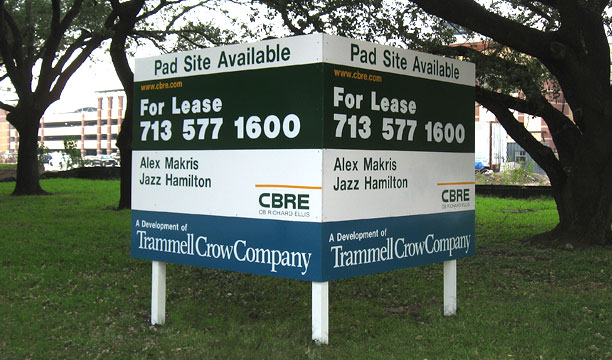

hello all,
was wondering if anyone help me determine if i need to plan to use stringers on a sign i need to install.
it is a 4"x4" coroplast sign like all realtors do these days as it is v-shaped so its actually 2 4'x4' corplasts.
gonna be mounted on 3 (4"x4") posts. do you think i need to use a stringer across the top and bottom of the coroplast sheets or will the coro be strong enough to hold up for a while without stringers?
thanks for any advice...

Personally, without any kind of backing boards, I think you're building a problem waiting to happen. Stringers alone won't cut it. They might hold up for a while, but it's not a professional approach at all.
Think about it..... what did the first two little piggies build their houses out of ??
max
i see what you are saying. it seems as though i see a fair amount of them made out of coro.
never really paid attention to if it had a peice of plywood for a backer. i guess i always assumed it was stringers...
max
but also keep in mind that it is definitely not permanent. do you think it will hold up for a year with just stringers?

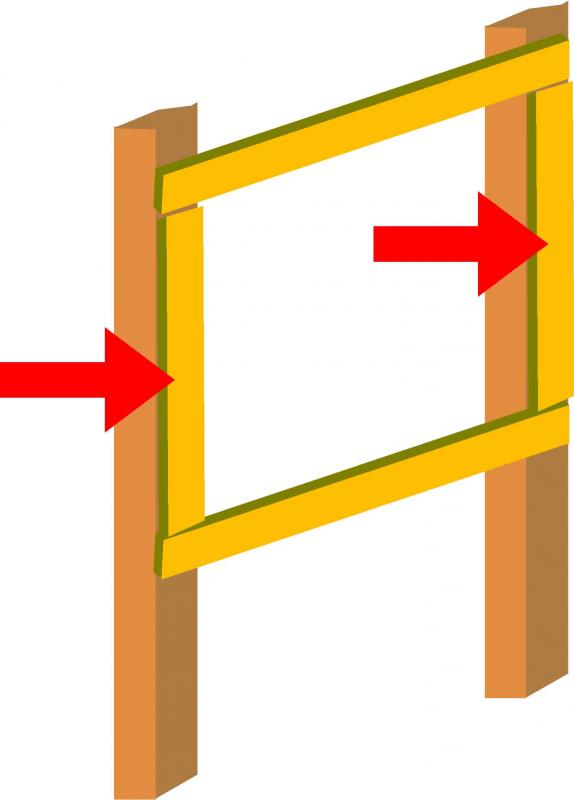

You can do it out of 4mm coro without a backer (or if you've already done it) but it's gonna look bad in no time at all. If you do this use lath screws to attach it. They've got large heads, almost like a built in washer. Sink them snug and cover with a vinyl dot. I've had them up for over a year like this. The biggest problem is the coro is going to expand and contract a good bit so it will be bowed in or buckled out all the time.....usually both at the same time.
Also, if you do it with just stringers make sure you add the vertical pieces to the posts so you've got an even surface on all four sides to screw in to.
