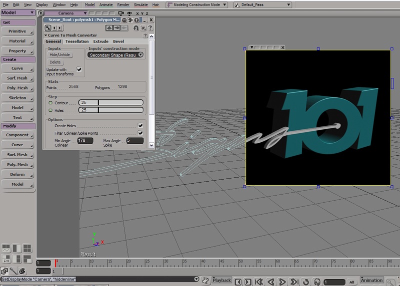

Now if you want the real deal and go full on hardcore 3D, ask me about XSI....

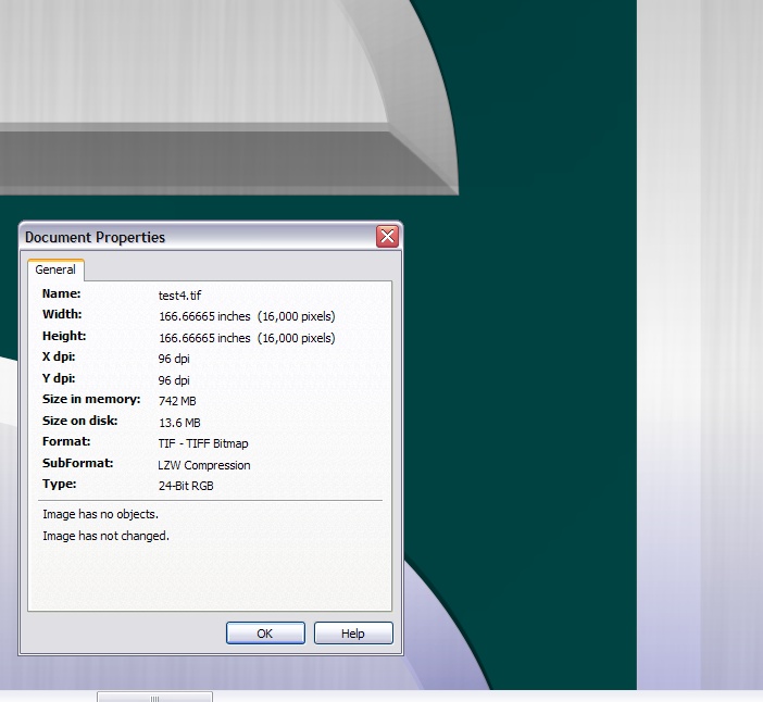

Hi Wayne, do you know if it is possible to export an object from zara3d6 or xara xtreme pro to a vector format? [I created a simple text object in Ai, imported the object to pro and then saved as .xar, opened file in xara3d6, applied simple 3d effect.] I want to save the finished file in vector format, so I can open in Ai, so I can resize to a size larger than the 2000 pixel frame size limitation of zara.
I think Xara's effects are live only inside of xara so they get flattened on export. The bevels, shadows etc will become bitmaps same as most other apps.
You should be able to get much larger bitmap pixel exports out.
Xara's workspace can be a little quirky at large sizes.
Try this:
Forget about page size and all that stuff - just leave it at the default.
Draw a box and convert it to a shape.
Bring all your graphics to the front so the are within the box.
Select all and resize the box using the size boxes in the toolbar.
export that out to a tiff with alpha.
I did a test and mine(older version) tops out at 16,000 x 16,000 for rasterizing a bitmap.
The effects - bevel's shadows etc... look very sharp at this size and would scale up a good deal more outside of xara before detail started to get lost.
I believe Xara 4 limit is 32,000 pixels for a single image now.
