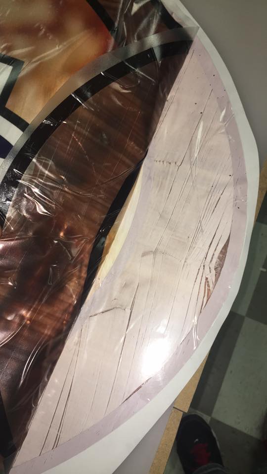

I have only went through one roll of this stuff, but it is very finicky. I printed a graphic, left it to outgas for over 24 hours, laminated, cut, then went to apply. Used application tape due to floating elements in the design. When peeling back the application tape to apply, the laminate completely lifted from the vinyl, and pulled all ink with it. I was back to white vinyl, with a nice translucent print on the laminate lol. Contacted my 3m rep, never received a solution. Used the rest of the roll with no problems.

heyskull
It is a very strange material indeed.
You can heat it and heat it and it seems to stay stable.
I think maybe the issue you had a start of the roll Dunbar is a contamination one.
