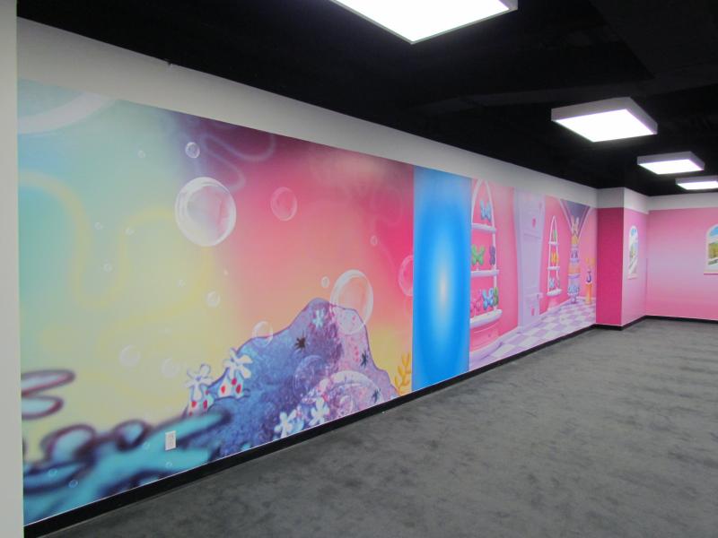

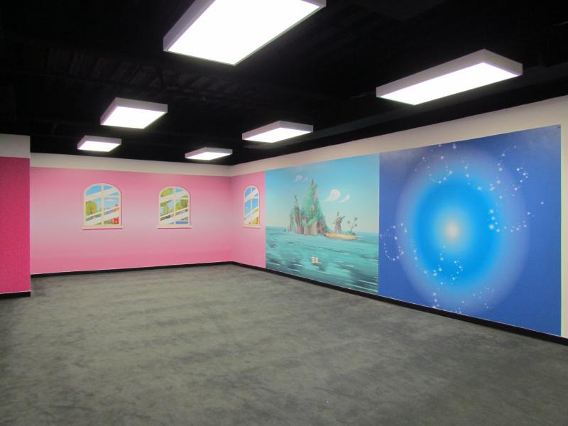

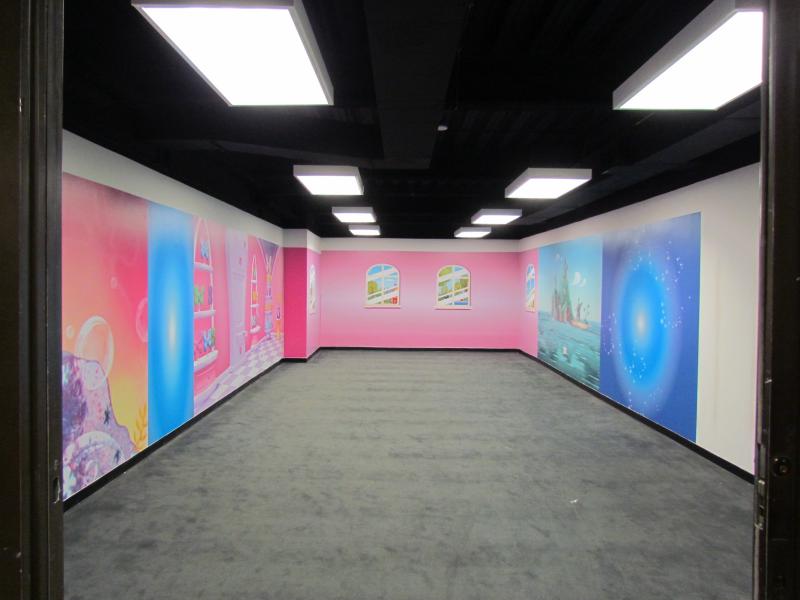

Got two rooms of this done today, but curious if there are any specific techniques I may not be aware of when installing? I used a 6" squeeze with a felt edge. Wondering if one of the Big Squeegee's would have helped.
It's pretty forgiving stuff, but tends to wrinkle up easily - I think from being so thin. Middle lays easy, edges tend to wrinkle.
Anyway, haven't messed with much of it, so any tips would be appreciated for future use.
Thanks!

ij40 is one of the easiest vinyls to install.
Wrinkles are most likely caused from not being installed evenly all the way down or side to side. Be sure to stay level in tacking.

I often use one of my BS yard sign tools to help lay big pieces of vinyl faster. The soft felt edge doesn't damage un-laminated prints (if applicable) and the size really makes it go faster. However, depending on the circumstances you still may need to go back and touch up with a small squeegee if you don't apply even pressure. Give it a shot. :thumb:

Thank you for the responses guys. You're probably right - I was likely putting uneven pressure on the roll as I was pulling it down. I really think the Big Squeegee would have worked. Oh well, maybe next time.
Thanks again, I appreciate the responses.
