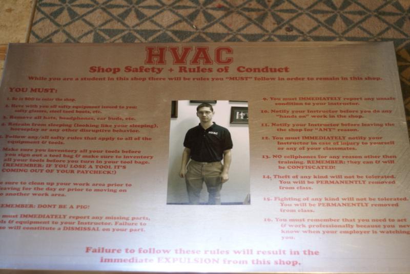

Ok , so here is what happened.
I set the printer to Glossy photo and printed it out

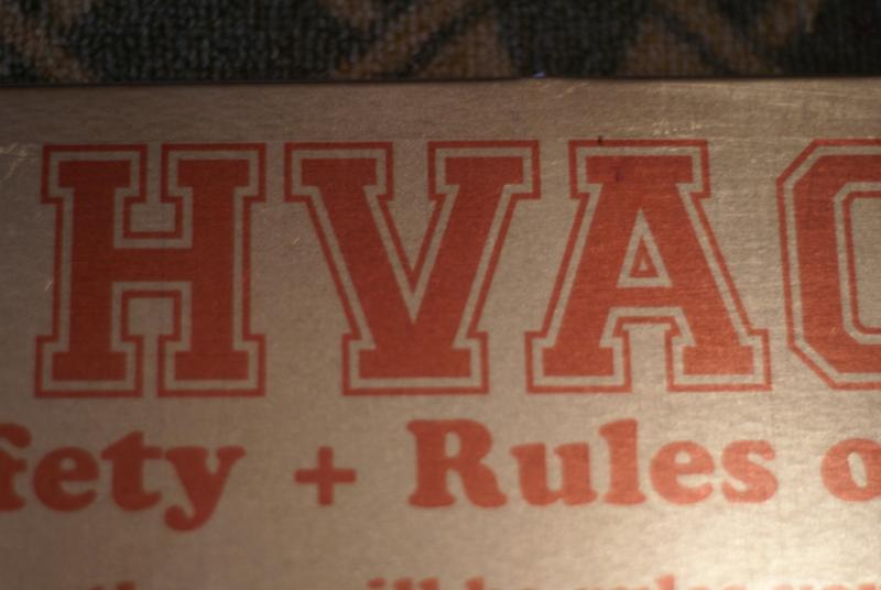

Here is a close up
I did have to laminate with 3M 8519 luster overlaminate because the lettering would just wash off ( even rub off).
I tried to do some black lettering but they came out with lines and sploshed. I think with playing with the settings more I could get it to work but no matter what it will need laminated.

oh , the pic was provided by the customer,lol
I copied that on to Kodak production self adhesive glossy poly poster plus and laminated it with the same 3m overlaminate as above
