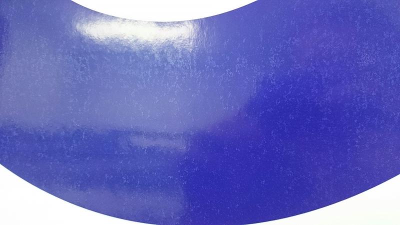

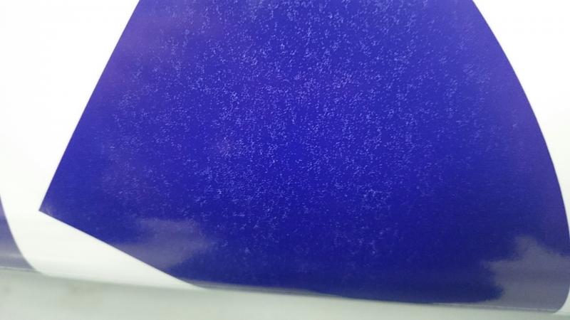

I changed from Arlon DPF6000XRP a few months ago to Avery 1005 EA RS and my installers are very grateful. I've had some serious issues with quality though, I've had to return 3 rolls all from different batches due to contamination, the surface just wouldn't accept the latex ink. I'm pretty disappointed in the quality and how much money it's cost me, and am looking to change to 3M 180c as well.
I've been running MPI1005SC since release and have never seen that type of contamination, our HP Latex machines print beautifully on the stuff. That being said, we are typically applying to box truck, tailers, and Econolines, no deep ridges though, and yes it is fairly thin but no product failure. Have had far more issues with 3M products, fuzz and dust visible on the roll before I even take it out of the bag, massive color shifts from roll to roll, and horrid corporate practices to name a few.
If you wipe it with ipa, it will accept it. We wiped the whole roll because i needed it and didnt have time to get anything else (and it was for my own van). I think atleast for a year avery have had serious issues with 1005 ea rs and latex printers, and we dont buy it until problems are solved. i have heard that some of the rolls do work and some dont, sometimes it works when the rolls are new , and after month or so it doesn't. Who knows..
Wow, that's a lot of effort to go through. Luckily I had a 60" roll to swap in and it printed fine. The 3 rolls I sent back were from batches at least 3 months apart which is worrying too.
I like the way they claim to have no idea about the issue... every time you return a roll.

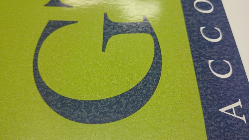

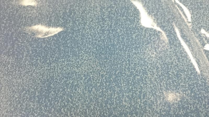

I must be doing something wrong, a new roll of Avery MPI1005 and more problems. It's printed fine for the first third of the roll then it just started with problems all of a sudden. They were the least noticeable when I cranked the heat to 120[SUP]o[/SUP]C drying temp 12 pass, but still apparent. Then it just stopped about 5 metres later.
