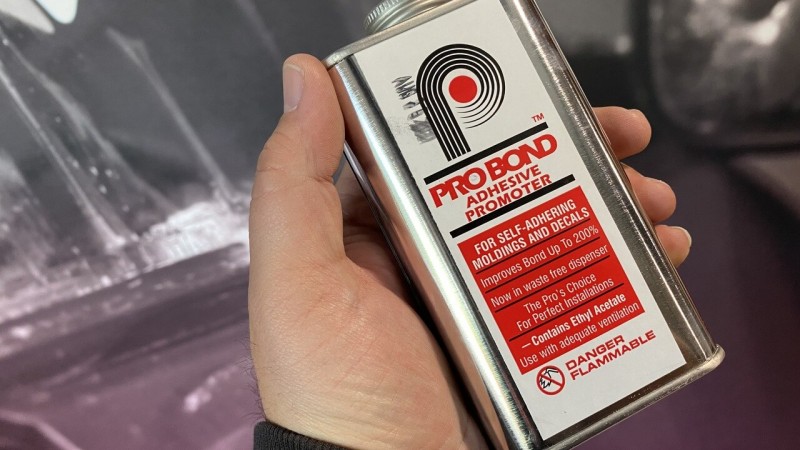

just looking at the Probond, do you have a product number for it as there seems to be a hole heap of products out there
