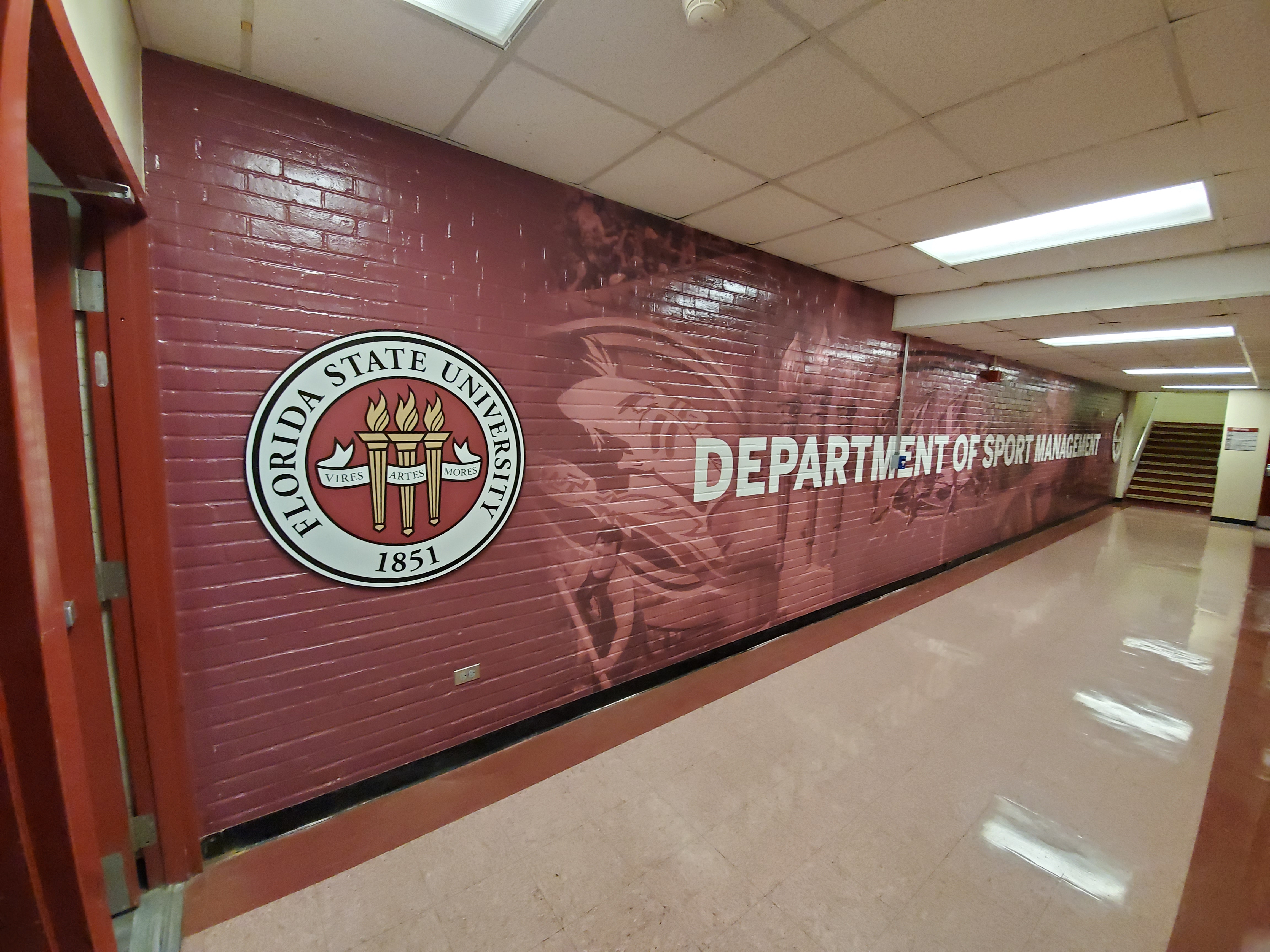

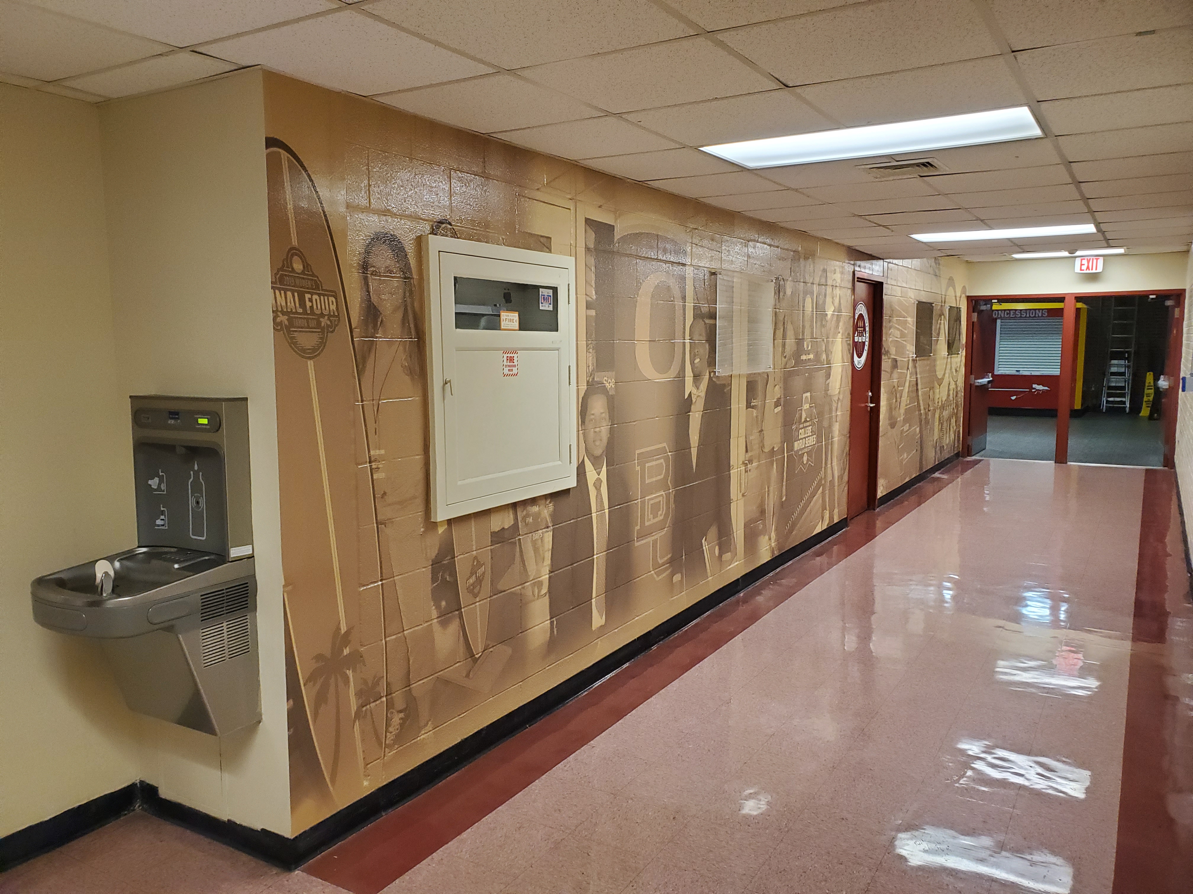

    This is about a 1000 sqft and about 4 foam rollers.
