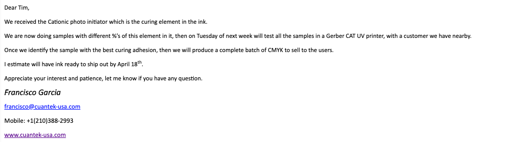

I just received this message from the ink supplier in Texas.
lol I also got the same message after I posted.. we will see, If the ink is going to be more expensive I may still convert the machine, I have less than $500 invested into it, so it may make sense for me to do it. I will try the texas ink if viable. may not be a good long term plan with only 1 suppler of ink though. we will see.
