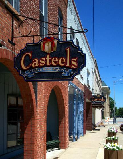

    Interior or exterior? On exterior signs we usually build a 1''x1'' sq. tube steel or aluminum frame and sandwich it between two HDU panels. The one attached has been up seven years approx. 42''x5':thumb:

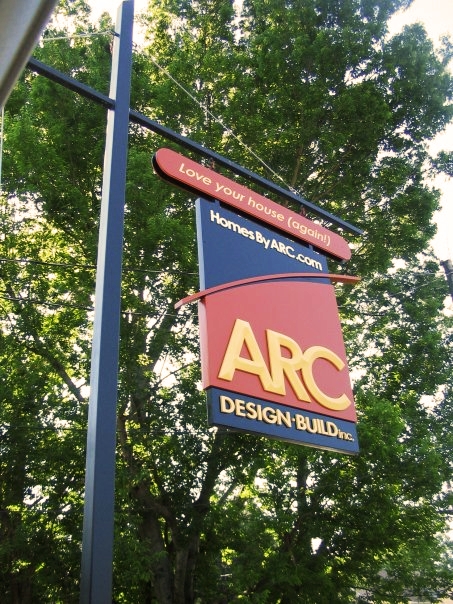

    It can be done with a little planning. On it's own I wouldn't trust it but with some structural metal built into it yes. Also the design will dictate how that is going to be done.
    Here's a complicated piece I did about that same size using a combination of welded steel, PVC and HDU.

    I know that ARC sign! Some friends of mine own that place. Cool!
