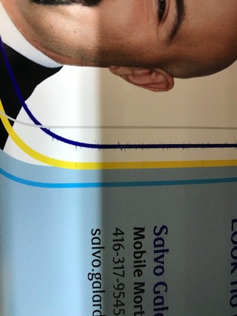

I have a JV 150-130 and up until last week it was printing great. No changes, running the same profile but I start noticing in darker colours what can only be described as a smear. I have run nozzle washes and cleanings and on dark colours it keeps making this effect as you can see in the pic. Photos and lighter colours print fine. When I run a test print all nozzles are fine. I have a feeling it is Flexi causing this but not sure how or why or even how to rule it out over the printer except the test print looks fine which is not from Flexi.

Check the bottom of the head for any inkcicles especially if you print a lot of banner. Usually that pattern means something is dragging from the head and smearing the ink.

We had that happen after a couple good sized banner runs and some lint, fuzz had built up on the middle ear of the media jam detector.

I have looked but cant see anything..but what can I do on a head like this to try and clean it? Your not supposed to touch them.... Oh the horror. I now see in some older prints from last week where it was starting.

The media jam detector is on the bottom right end of the printhead carriage. It has some give in it and hangs just low enough to pickup lint and fibers from banners and then it brushes against those white foam wipers right behind the damper, picks up a little ink and then it just builds up. We've owned ours since October and I've had to clean it three times already.

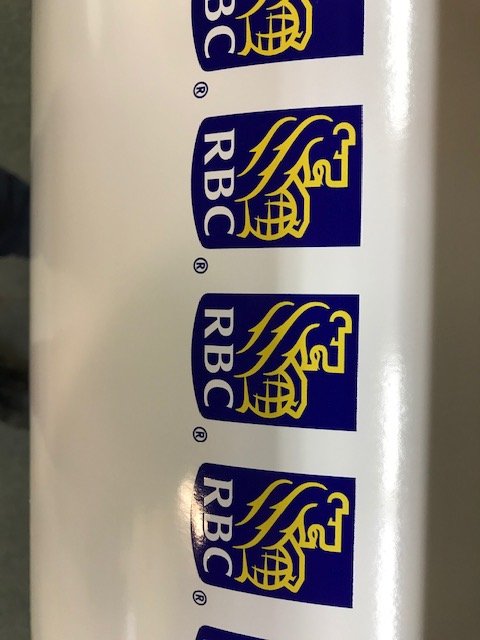

I found some lint buildup right at the back of the carriage hanging off a black piece of plastic....I was never instructed to even look there for debris. Going to run a test. test is perfect!!!!!!!!!!!
Thank you so much to all of you for your help. This site rocks!!!
