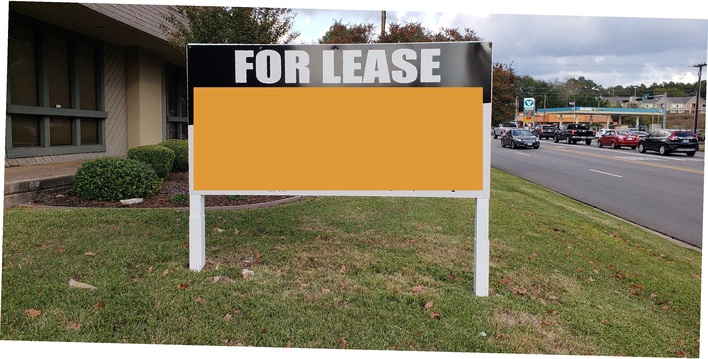

Questions I should have asked first...Why? What is the issue that has them making this request? Are they temp or permanent signs? For permanent installs we like to add a collar around the bottom of the posts when we install so there is a couple of inches of concrete out of the ground. That protects them from weed whackers and lawnmowers which can trash vinyl post covers.
Haha, exactly why I use them! We replaced about 10 leasing signs for a client a few years ago and the old poles over the years got beat to hell from the weed whackers. We put 2' collars at the bottom (posts painted white to match) and they seem to be holding up much better.
