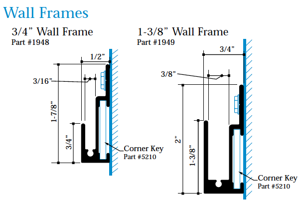

use this stuff all the time:
only visible hardware are the counter-sunk screws for the end caps.
Extruded Aluminum SignComp Wall Frame

thanks a ton guys, I have plenty of it laying around from other projects. I didn't want to go with plex in the first place but apparently its the only sheetgood available in 12' anymore without waiting for a special order.
