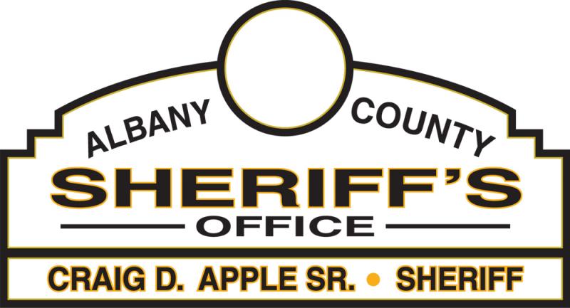

One last thing. I posted the artwork for the sign. The text sheriff's and craig... has a gold stroke. Does that represent that the shoulder is to be painted gold, or that the stroke is to be raised as well? The black text is to be reflective vinyl. This job fell into my lap becasue of a falling out with another sign company.
Eric H
Your asking the forum what your artwork represents? How did you price it if you don't know how it was going to be constructed or painted?
Signed Out
This job sort of fell into our laps... We haven't done a routed and painted sign before... The price of the routing shouldn't and doesn't (because I checked) change based on whether the stroke in the artwrok is raised with the border/text or represents the shoulder of the raised border/text, very little difference to the router. I was asking because we were provided the artwork with minimal description/instruction and want to make the sign as best we can. That being said I have been doing a lot of research on sign foam3, how to work with it and paint etc. I'll be starting a thread soon about the procedure I come up with and look for tips and suggestions. Oh we decided that the stroke on the border represented the shoulder was to be painted gold, and that the gold stroke around the text was to be raised with the text as well as gold painted shoulders.
