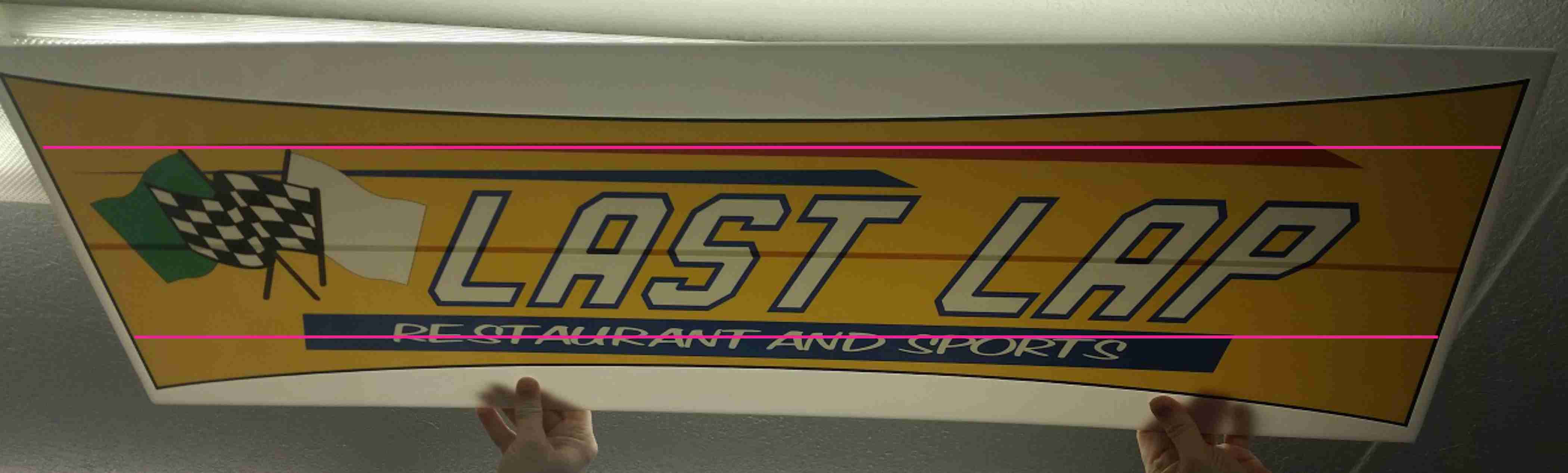

Here is a scale version of the sign. 12" tall with 1/8" overlap printed on Oracal digital.
I seriously considered painting with translucent yellow and masking the areas for the letters and printing/placing those in later but I dont have a way to transport or a paint booth for these bad boys.
What about doing 48" wide prints butted up against each other to avoid the overlap?

No knife marks just lots of left over glue and ghosting, that what we are thinking of covering entirely with print. It is about 30' up on posts and view heavily from a highway. See my photo reply above

Little hard to tell what exactly is going on, am I seeing some serious distortion in that pic? Anyhow, how about "hiding" the seam in the design, have two seams run through the areas that have panels. Less noticeable than one long one in the yellow.
If that's an 1/8" overlap, then you have some mighty small hands/fingers. :confused:
Anyway, the overlap does look bad. If you can't talk them outta of the yellow background, then sub it out to someone who has a printer that can do it all-in-one piece. Regardless of using a new piece or this one over, you can't do it, as is. That's quite evident. Do you even know how to paint with grip flex translucent paints ?? That's a lotta yellow to get down perfectly, not to mention a lotta frisket cutting.

+1 on overlap in line. When I have to overlap on trans I try to place it in a "busy" section.

I have no idea how to paint with the translucent paint, outside of knowing that it existed. Is a wholesaler that can do it in 72" wide? All the ones I know cap it at 54"
vincesigns
if you are going to seam two pieces of printed translucent vinyl you have to have an overlap otherwise the two will shrink over time and you will have a gap between the 2 pieces and that will look really bad. If the sign is 30' high and you have a 1/8" to 3/16" overlap I don't think that will be easily seen. Your client will need to compromise if they want to reuse the existing faces. Otherwise retrofit with printed flex faces. You can work with AI Innovations or Z3 Graphics and they will help you with that. Their prices may end up being competitive with what you are proposing to do when you take labor into account...
