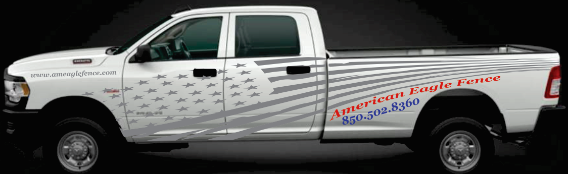

I say it's not possible but is there a way to achieve a brighter red when printing to metallic vinyl.
Using an HP360 with no white Ink
Increasing the number of passes will produce a "richer" red but will also eliminate the effect of the metallic look.
We did some vehicle graphics on a couple of trucks. Majority was straight silver metallic. Then for the business name I was asked to print red to the silver metallic. Of course I knew it wouldn't be a bright red as the silver would bleed through but do they listen to me.
So now they want to add to the tailgate but with a brighter red. Perhaps there is a metallic red vinyl out there. I'm going to ask my $$ person to look into it.
That's the only way I see.
