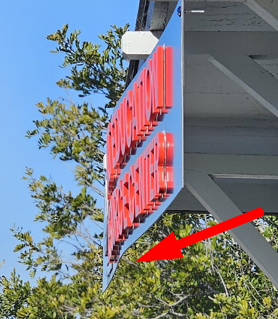

Hi Everyone,
We installed a sign about a month ago, and now the sign is warping. The sign was made with 3MM ACM and there is no back support. The sign is hanging from the top 2 corners.
Do you have any advice on how I can repair the sign? I am wondering if I can add an MDO layer on the back to give the sign additional support.
I also think I might need to remake the entire sign again: what material should I use so that it does not warp?
The sign is about 10'x1.5'.
Any help is greatly appreciated it.
Thanks,

You need a frame behind it... Attach from the top and you won't have those ugly long bolts hanging out the back. And put a backer behind the frame to make it look nicer. Make sure to secure it properly... It's a heavy sign to be blowing around in the wind hanging on that not so confident looking wood

Over that length (looks like 8'+/-), there's not a lot that won't warp over that length (with what looks like limited attachment points) without some sort of frame, and/or support along the edges. An ACM pan would work, and allow for "hidden" attachments). Alternately, you could put angle or tubing around the perimeter to "stiffen" it or, you could use 1/4" aluminum for the backer (in which case you'd need some serious attachment hardware).

I agree with the comments above. This thing is scary and needs to be taken down before someone gets hurt (or at the very least, falls down and gets destroyed). Yes, it does need a frame, supports, solid anchoring etc... but if those things were already skipped the first time around, I'd be concerned about your installer's ability to construct those things correctly anyway. (not trying to be mean. just honest) Please get another sign shop / fabricator to perform a site survey and have them repair / install it before it lands you in court.

3mm ACM is a not a load bearing material. Hell, even 6mm ACM isn't for that matter. Enough people have picked on the original poster, but the practices of doing things on the cheap is far too common in our industry. Too many people are "phoning it in" and just do not care at all about the quality of the finished product. Just collect a paycheck. Who cares about pride in one's craftmanship? I get the feeling that caring about doing a good job is only for losers in our business anymore. The standard of suck has gotten so bad in recent years it is not funny.

ACM is a beautiful thing. A game-changer, really, when you compare it to the old labor-intensive MDO plywood. And the way the panel is installed in the picture might work, Norma, if the material were something more substantial. If I were making a panel like this for a customer and I knew they were going to install it like this, I would have used .080" aluminum, preferably with a back frame of square aluminum tube or 1/4-thick aluminum angle. This would accomplish two things. It would not warp at all. But also, it would be so heavy that the installer would be forced to use some substantial method for fastening it to the building. He would be scared not to.

It is hard to see what the board is mounted to and how you've got it secured. The reason for the warping could be a lot of things. Just at first glance, it looks to me like the installer had drilled 2 holes for the bolts, but drilled them farther apart than the anchor points the bolts were attaching to. My guess is that he had to squish the sign a little and that caused that bowing in the middle (it would not have to be a that far off). Keep in mind also that these structures swell and shrink with the temperature and humidity, so whatever you are anchoring this to is likely to put some stresses on your panel - especially at 10 feet wide. You might want to ream out the bolt holes a tiny bit so that the anchoring bolts have a little play.
You could take the panel down and beef it up with some kind of frame or partial frame. Considering the weight you'd be adding, and the pedestrian traffic underneath, I'd suggest a more robust anchoring plan. Build for safety.
Either way, this is recoverable. Probably going to take some time and material, but you can fix it.

Its in the direct sun. ACM expanded in the heat and due to mounting holes it had nowhere to expand so it bowed out. ACM mounting holes should be a little larger than the bolts going through it. Also it very much needs a frame and more mounting points. One strong gust of wind and thats going to come down in a violent fashion. Structure behind appears to be wood, you could probably get away with a wooden frame.
